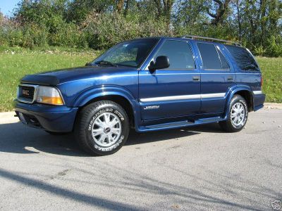

I recently had problems with my heater 'the vents send cold air,I fixed that problem by flushing system...,heater core ..etc.
now I can not shut off the heat off ,all the vents send only HOT,HOT air,, not cold, not warm..THE AIR CONDITIONING NOT WORK :( what happened? please,please help me :)

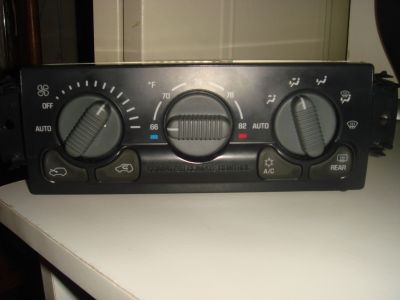

Hello ,i changed temperature control switch , still sending hot air from te vents :(
everything start when my heater not work,then i flush the system new coolant in the radiator etc.
after i flush the system i get only hot air i move the control to (blue meaning colder ,the vents sends only hot air.

Let me try to help,
The temperature switch controlls a vaccum or cable linked door that diverts air through either your heater core (for heat) the a/c evaporator (for cold) or both ( for warm air). Look around the ventilation duct (the housing that runs from the blower to the vents) for any disconnected vaccum hose or cable that may come off during the time you serviced the heater core. I am almost certain thats the problem. Larry
