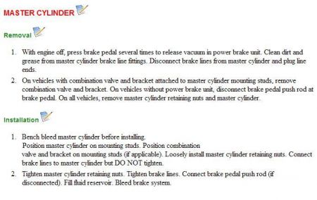

whats the easiest way to change this out?

https://images.2carpros.com/forum/automotive_pictures/261618_Noname_1055.jpg
