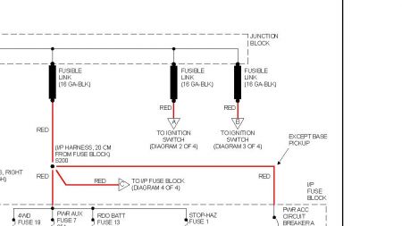

I do not have power going to the ignition side of the fues block. I can run a hot wire going from the battery to the fues block and make it hot then the Jimmy will start and run normally. I check the computer for codes and came up with no codes at all were present. Hope that you can help me and I will get a donation to you as soon as possible.

Check the fusible link at the junction block see below for the circuit involved.
https://www.2carpros.com/forum/automotive_pictures/12900_fuse_block_2.jpg
