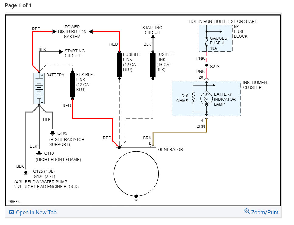

My Jimmy does not charge the battery when running.It reads low voltage and has had 2 new batteries and also 2 new alternators.

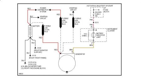

Check all the fusible links and gauges fuse no.4 10amp, inspect the brown wire if its open between the alternator thru charge indicator to the gauges fuse no.4 10amp holder
https://images.2carpros.com/forum/automotive_pictures/12900_alty1_28.jpg
Please check the gauge fuse and the fusible links also check the main power wire at the alternator. Check out the images (Below). Please let us know what happens.
