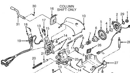

I've put in a new starter, battery, and alternator. As well as fuel pump and filter and all oxygen sensors. I turn the key and the starter won't engage, the only noise I hear is the fuel pump. The lights don't dim at all when I turn the key. The ignition feels exactly as it does before when the truck ran great. I thought it was the starter so I replaced it along with the alternator. But still when I turn the key nothing happens. I can leave the key turned and jump start the truck by touching the solenoid with a screwdriver. What can I do to solve this problem?

What you have described is a failed ignition switch. You can run a temporary starter switch to fix this issue short-term. The primary fix is removing and replacing the faulty ignition switch.

That is correct. I have posted replacement steps below to help you if you choose to do this repair on your own.. Remove the column shroud halves. Remove the column-to-dash attaching bolts and slowly lower the steering column, making sure that it is supported. Remove the multifunction switch if necessary. Remove the key alarm switch, if equipped by gently prying the alarm switch retaining clip with a small screwdriver. Rotate the alarm switch 1 / 4 in. (6mm) turn and remove. WARNING Extreme care is necessary to prevent damage to the collapsible column. Make sure that the switch is in the LOCK position. If the lock cylinder is out, pull the switch rod up to the stop, then go down one detent. Remove the two screws and the switch. To install: Before installation, make sure the switch is in the LOCK position. Install the switch using the original screws. Tighten the screws to 12 inch. lbs. (1.4 Nm). Install the key alarm switch, if equipped . Make sure the retaining clip is parallel to the lock cylinder. Rotate the alarm switch 1 / 4 in. (6mm) turn until locked in place. Install the multifunction switch if removed. CAUTION Use of screws that are too long could prevent the column from collapsing on impact. Replace the column. Tighten the nuts to 22 ft. lbs. (29 Nm); the bolts to 20 ft. lbs. (27 Nm). Install the column shroud halves.

Well i went to the store an# they had my switch. Now i cant get mine out. I cant seem. To find the 2 screws yo remove the existing cylinder. Do you have a bettet picture of how to do this?

have you removed the plastic covers from the steering column? once the covers removed you should be able to see the screws holding the switch pretty easily

Yeah, everything is off, i just dont see these screws.....are they torx head screws? The cylinder is encased in metal. Im sorry, im usually very competant whe it comes to this type of work. As ive said, ive replaced everything from the battery to the rear axle and differential. I really appreciate your help. If i wasnt out of work i would donate more

the lock cylinder is not the actual switch. the switch is behind the lock cylinder. number 17 in the diagram i posted above is the cylinder. make sure the steering column is lowered and the two should be 7mm screws/bolts
