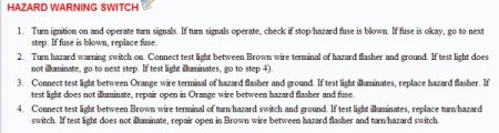

1995 GMC Jimmy take off streering wheel
1995 GMC JIMMY
10,000 MILES • 4 CYL • 4WD • AUTOMATIC
LITTLE DRUMMER
who to repair emergency flasher button
Jan 27, 2008 at 2:01 AM
MERLIN2021
  • 17,250 POSTS
Testing the switch...
