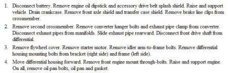

do you have to pull the motor to change the oil pump
Mar 2, 2010 at 6:01 PM
BLUELIGHTNIN6
  • 16,542 POSTS
no, not on the 4WD model. follow steps below to remove oil pan and gain access to the oil pump..
https://images.2carpros.com/forum/automotive_pictures/261618_Noname_1818.jpg
