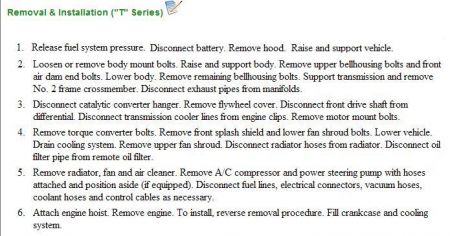

i'm trying to change a motor on the above listed and i don't know how to disconnect the torque converter off the flywheel,do i have to taka the oil pan off to access these three bolts connecting the flywheel to the torque converter?
