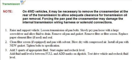

I CAN NOT GET THE PAN OFF OF THE TRANSMISSION TO CHANGE THE FLUID. AND IT DOES NOT HAVE A DRAIN SCREW. SO WHAT DO I DO TO GET IT OFF ?

https://images.2carpros.com/forum/automotive_pictures/261618_Noname_1219.jpg
