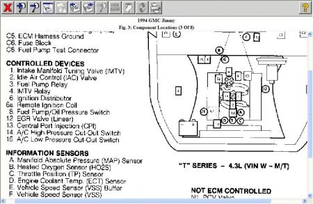

I am trying to replace my throttle position sensor in a 1994 GMC Jimmy. Can anyone give me a delailed description of where it is located or know a good place to find a diagram of my engine? It would be very helpful. Thank you so much!

The TPS is located on the throttle body-follow the accelrator cable where it meets up with the TB its right there see below position C
https://www.2carpros.com/forum/automotive_pictures/12900_TPS_1.jpg
