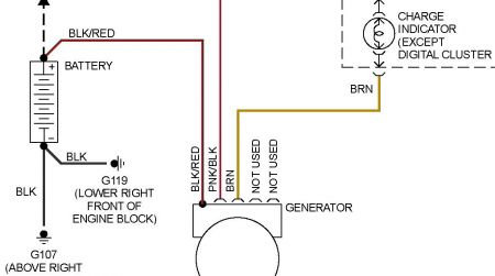

I put a new alternator on the jimmy and I plugged one in and there are two wires, one red and the other black. there is a bolt sticking out at the back of the alternator. which wire goes there and where to the other go?

See below
https://images.2carpros.com/forum/automotive_pictures/12900_alty_38.jpg
