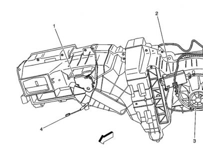

check to see if you have one of the hoses off. Your motor may not begetting the vacuum it needs to operate. it could be a vacuum hose off anywhere. youshouldn't have to pull the heater down to do that. it should look similar to this
https://images.2carpros.com/forum/automotive_pictures/406719_actuator_7.jpg
