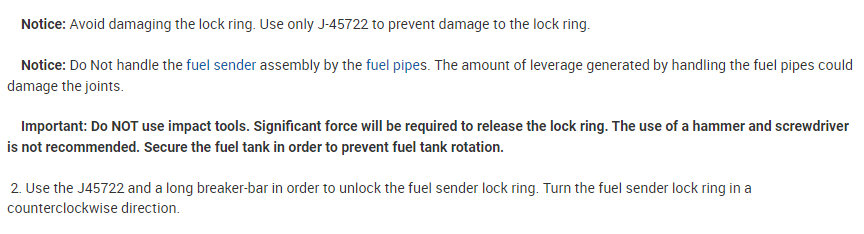

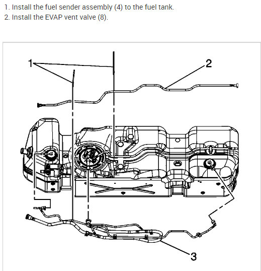

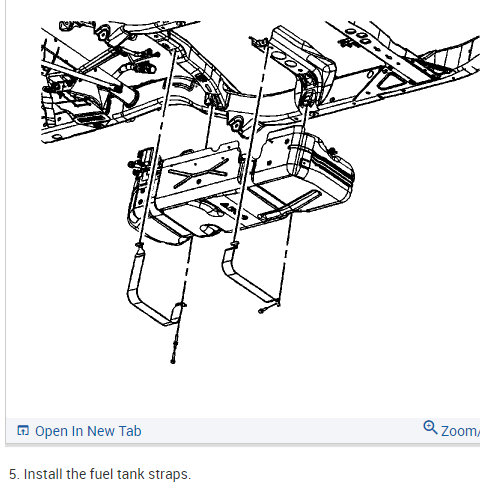

I have been taken for so much money..thanks for the site(smile) now for the question. My gas thing stopped working out of the blue. One day I simply ran out of gas cause the light that tells me its low didn't work. I can fill my tank up and it will tell me how much gas I have. But it seems as I go through town and with each stop it goes all the way to empty and the light comes on even though I have just filled the tank and minutes ago it said it was full. How costly and what is the cheapest way to repair. God Bless Kim
Nov 10, 2009 at 2:36 AM
DANNY L
  • 5,648 POSTS
Hello, I'm Danny.

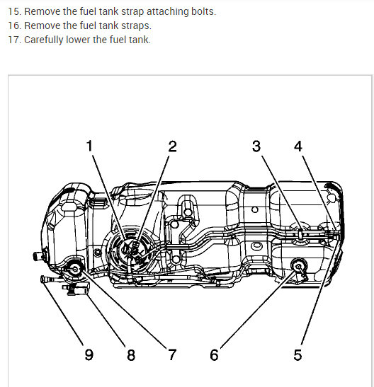

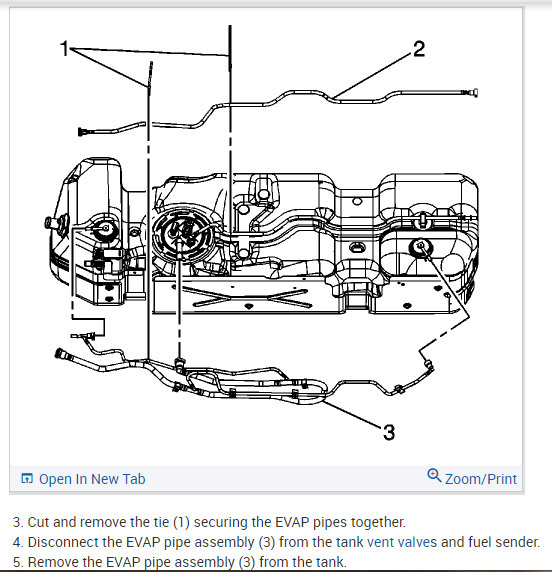

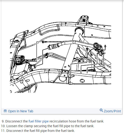

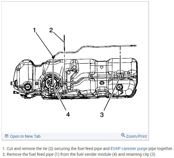

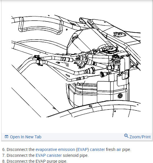

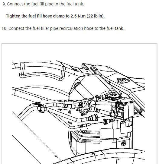

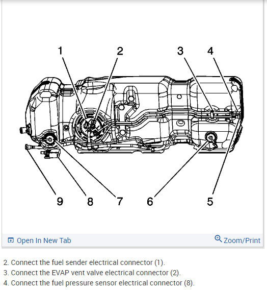

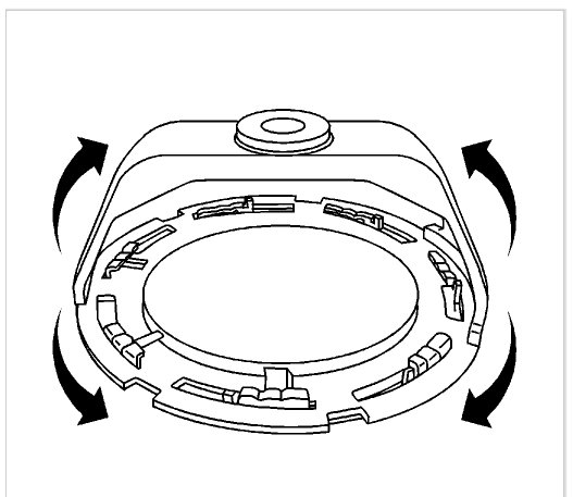

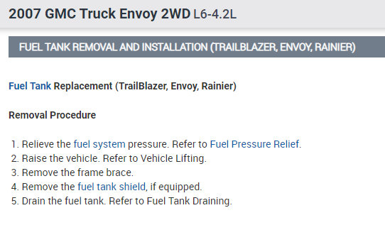

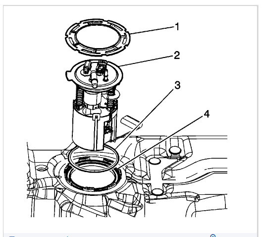

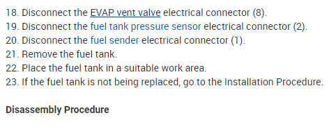

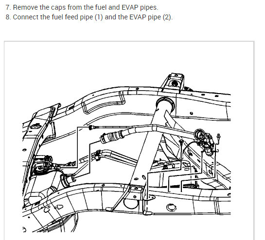

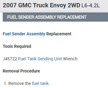

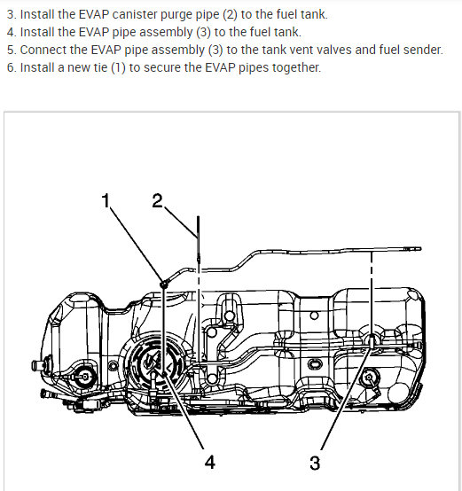

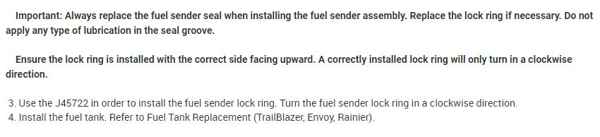

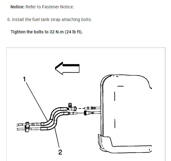

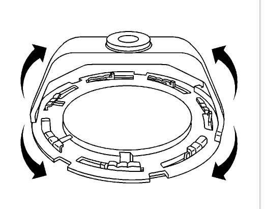

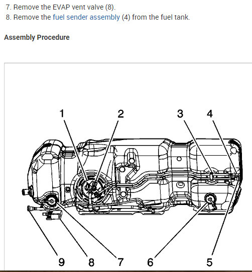

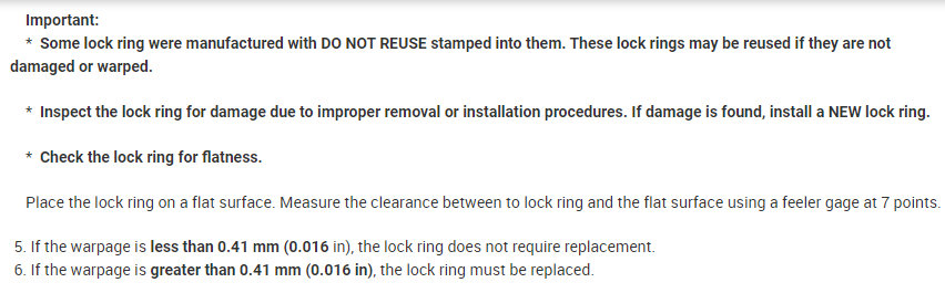

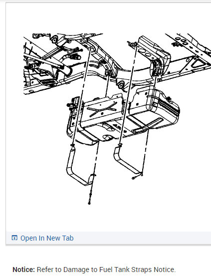

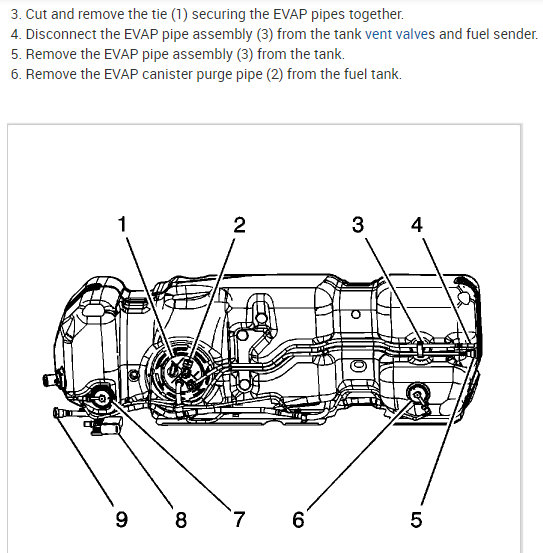

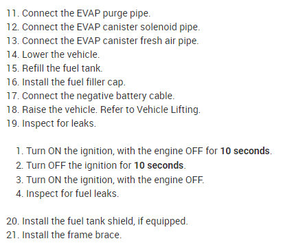

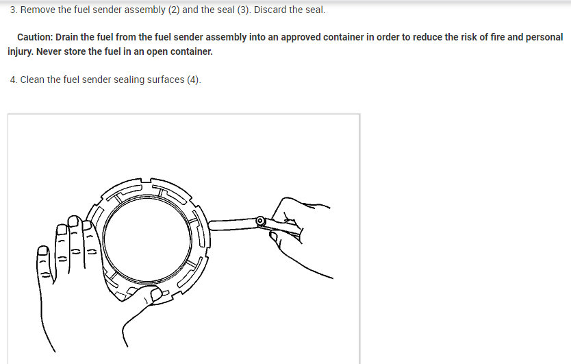

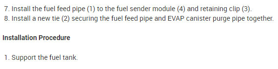

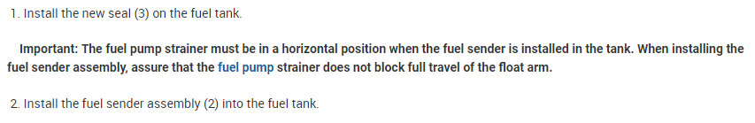

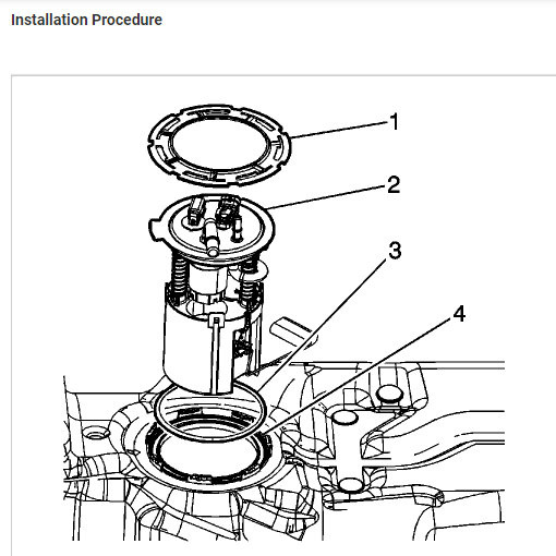

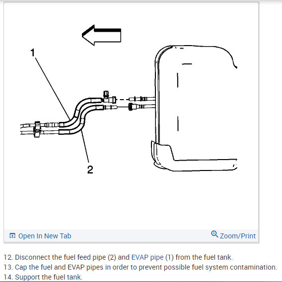

Here is the information you requested. It sounds like you are having an issue with the fuel sending unit. This unit built into the fuel pump assembly that is located inside the fuel tank. The fuel sender may be defective or failed and not giving a correct reading of the fuel level. You will have to change the fuel pump assembly to correct this issue. Here is a tutorial showing how to replace an in-tank fuel pump assembly:
https://www.2carpros.com/articles/how-to-replace-an-electric-fuel-pump
You will have to remove the fuel tank to gain access to the fuel pump assembly. I've attached picture steps below on how to remove and replace both the fuel tank and fuel pump assembly on your Envoy. Hope this helps and thanks for using 2CarPros.
