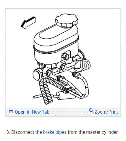

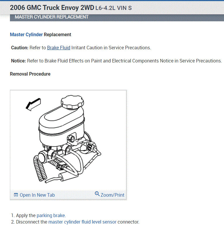

I have an envoy and when you're going down the road the brakes will start to go to the floor they say I need a brake master
May 5, 2009 at 7:50 AM
  • 110,244 POSTS

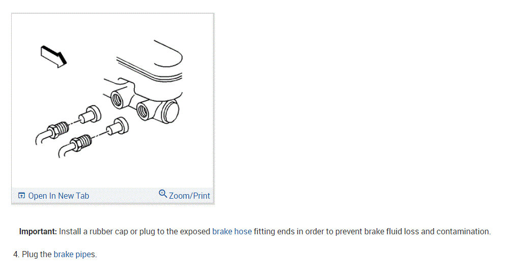

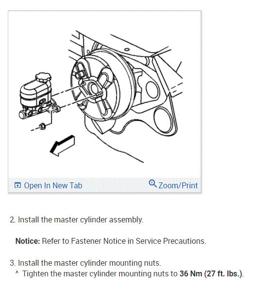

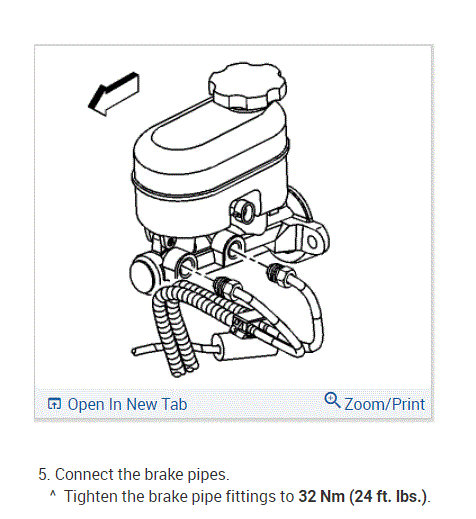

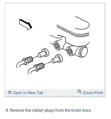

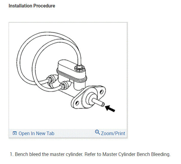

If the brake pedal is going to the floor, either you have a leak or the master cylinder is bad. First, here is a link that shows in general how to replace a master cylinder. You can use this as a guide.
https://www.2carpros.com/articles/how-to-replace-a-brake-master-cylinder
Additionally, you will need to bench bleed the new master cylinder prior to installation. Here is a video showing how that is done:
https://youtu.be/WDxvEQrMkBg

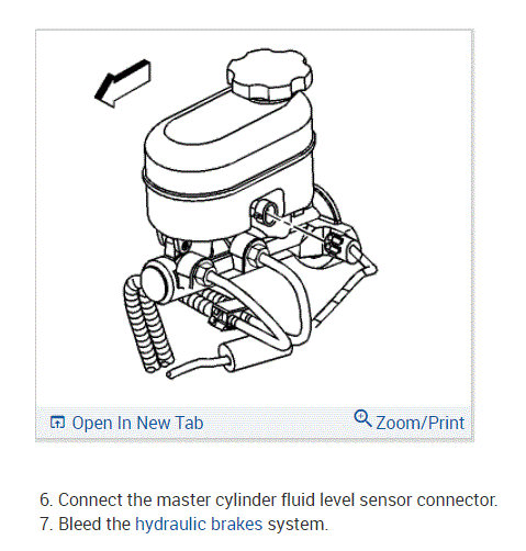

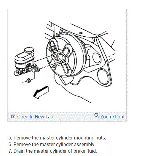

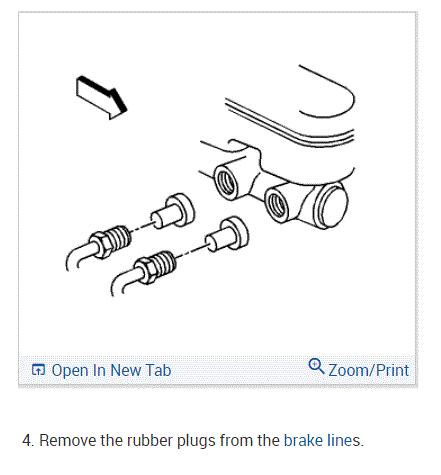

If you look at the attachments below, I included the directions and pictures for replacement specific to your vehicle.
