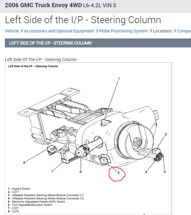

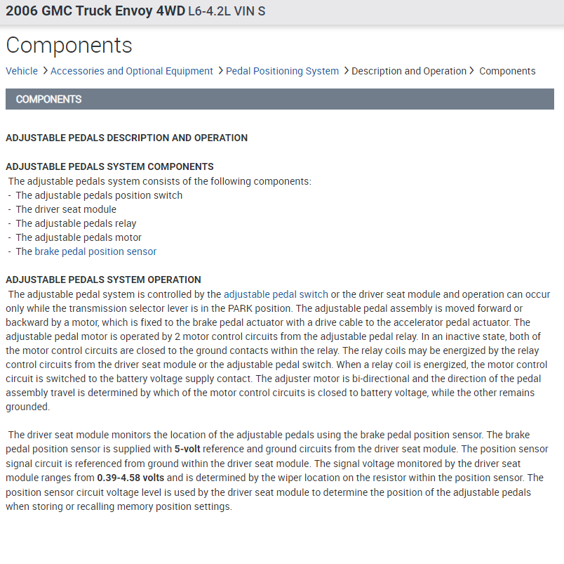

My adjustable pedals wont work what is wrong?
Oct 24, 2009 at 8:58 AM
SQM
  • CAR REPAIR CONTRIBUTOR
  • 6,383 POSTS

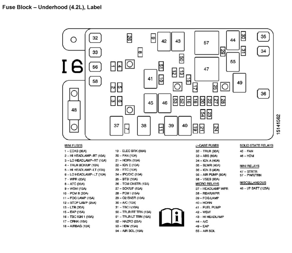

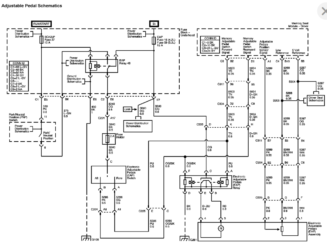

There could be few different reasons why the adjustable pedal is not operating.

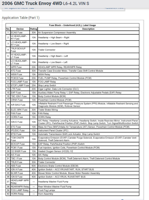

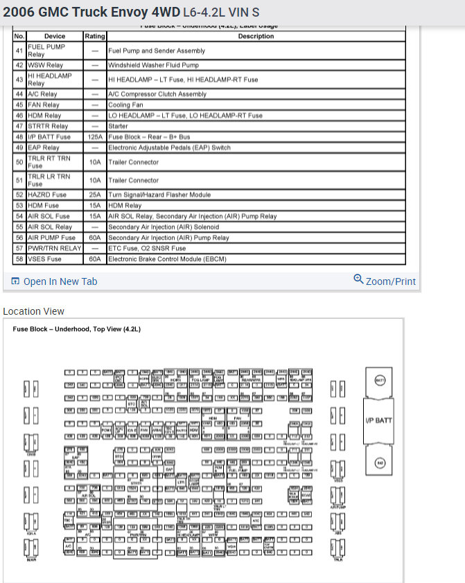

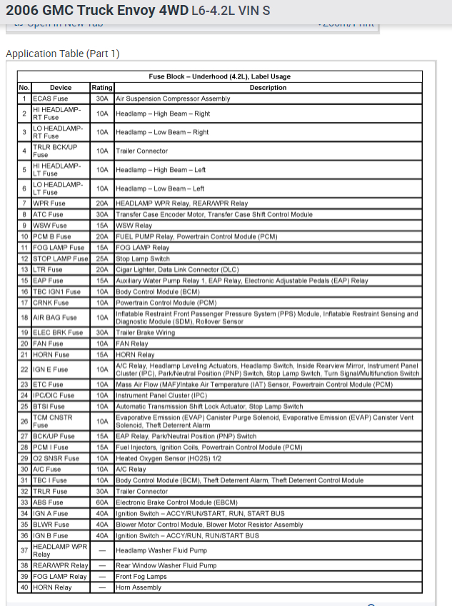

First check the fuse for that module. It is located in under the hood fuse box. It should be number 15 and a 15A fuse (see diagram).

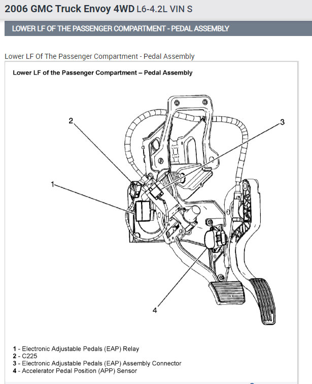

It can also be due to a bad relay. That relay is located next to the pedal assembly (see diagram).
Inspect the relay for any corrosion or burnt pin(s).
You can also test the relay:

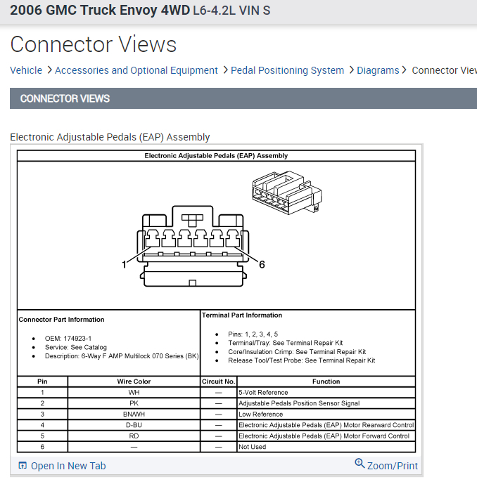

It can also be due to a bad module that is located under the pedal.
