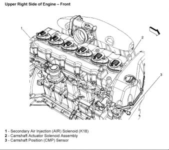

My car has been diagnosed to have a bad Cam position sensor. Does anyone know where exactly this is on a 2005 GMC Envoy and how difficult it is to switch out?
Thanks!
Jan 12, 2010 at 10:21 AM
  • 75,992 POSTS
Camshaft Position Sensor
https://images.2carpros.com/forum/automotive_pictures/12900_camshaft1_4.jpg
CAMSHAFT POSITION (CMP) SENSOR REPLACEMENT REMOVAL PROCEDURE

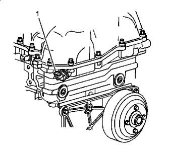

https://images.2carpros.com/forum/automotive_pictures/12900_camshaft2_1.jpg
1.Remove the camshaft position (CMP) sensor electrical connector (1). 2.Remove the CMP sensor retaining bolt. INSTALLATION PROCEDURE
