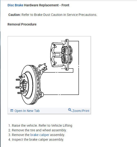

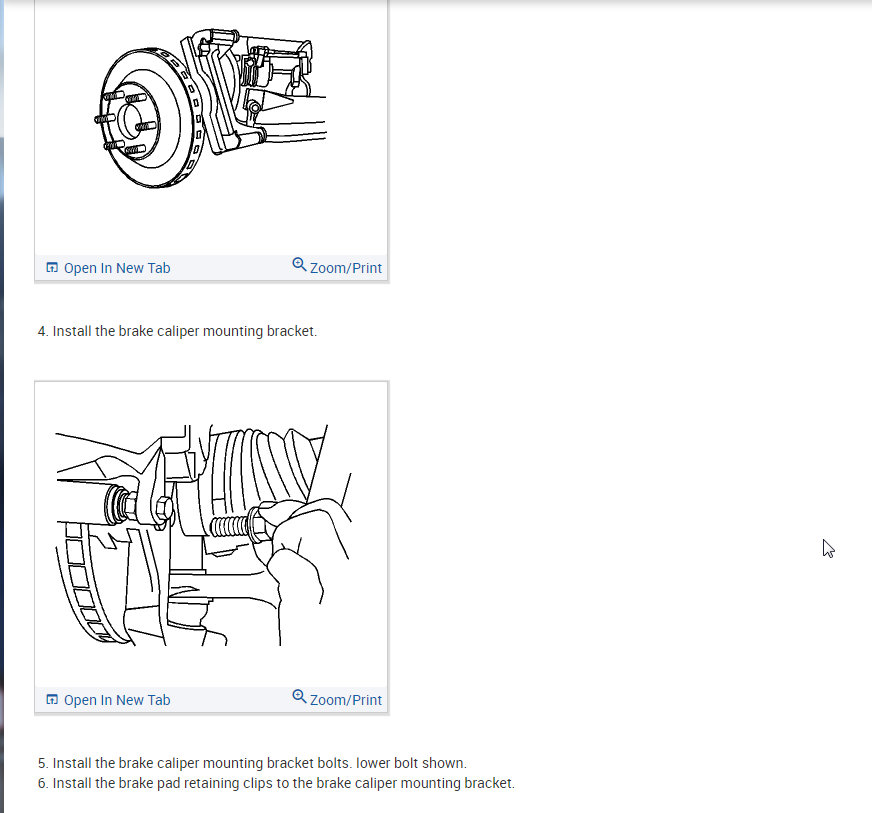

Wheel on front passenger side makes a squealing noise when the car is driven. Brakes do not squeak or grind when the car brakes is pushed down. Is this a rotor issue, or something with the bearings?
Jun 29, 2009 at 5:56 AM

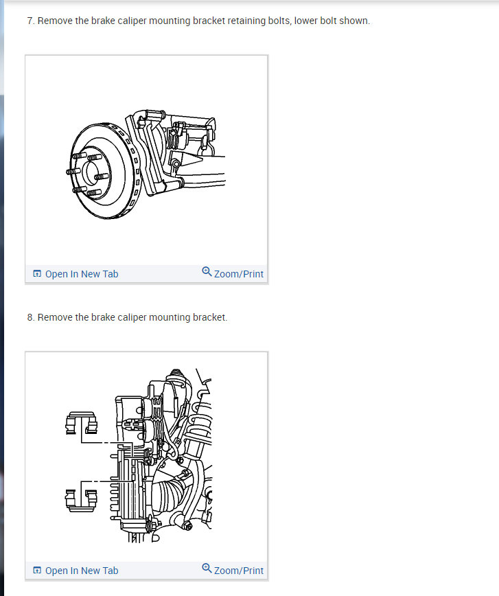

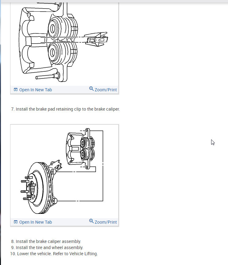

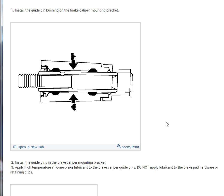

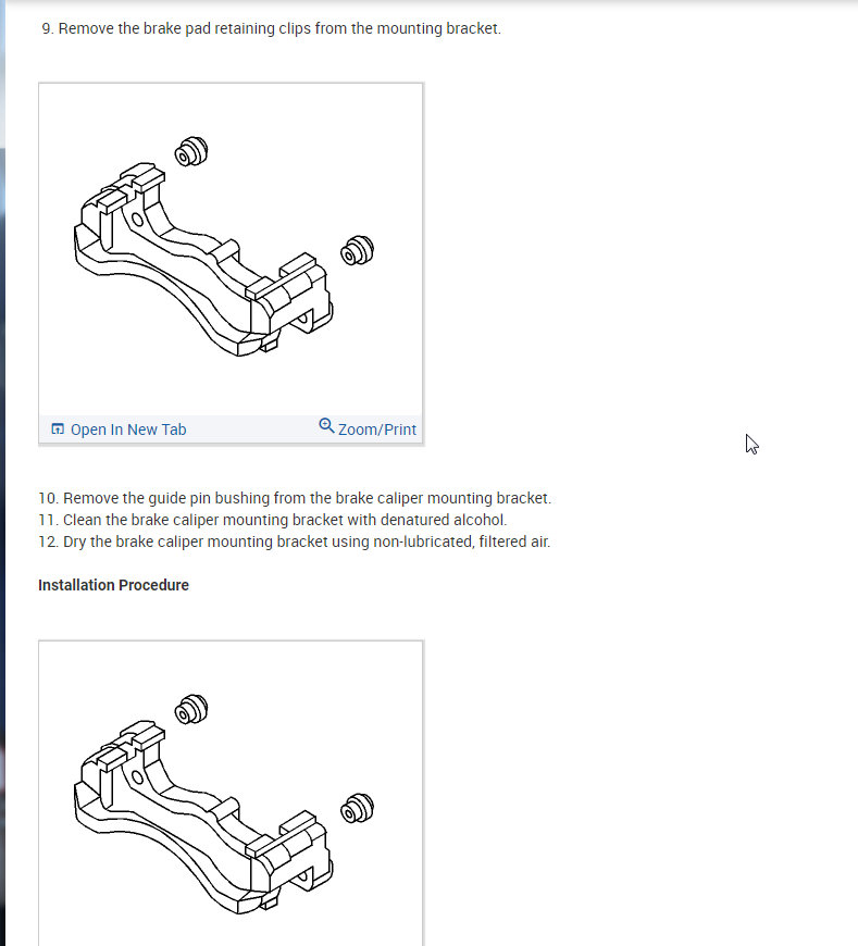

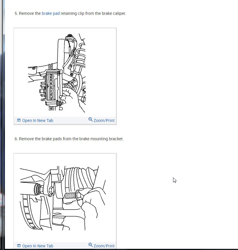

Yes. This is most likely the pad and rotor squeaking. Here are guides that will help with this:
https://www.2carpros.com/articles/how-to-replace-rear-brake-pads-and-rotors
https://www.youtube.com/watch?v=1dB17cMwSOQ
I would recommend changing the pads and rotors and below you will find the process from the manual. Please let us know if you have other questions. Thanks
