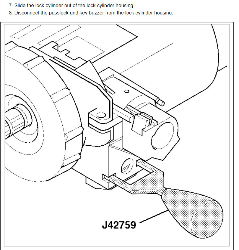

My key wont turn in my ignition but my steering wheel isn't locked.

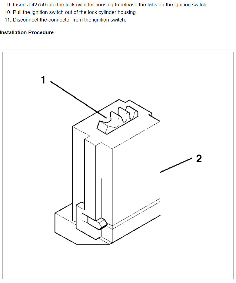

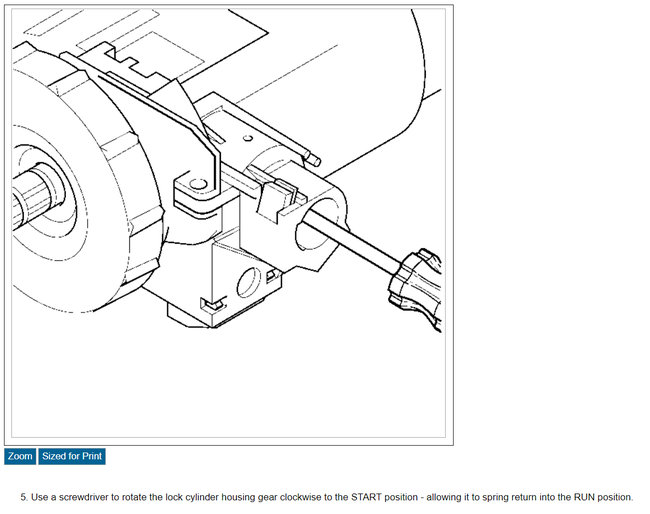

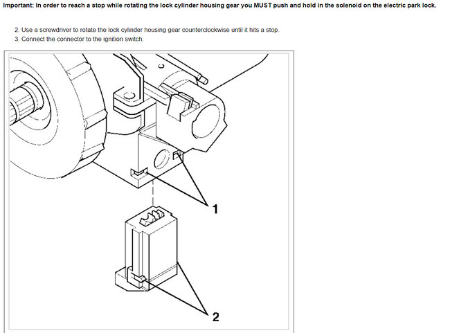

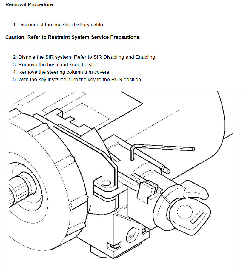

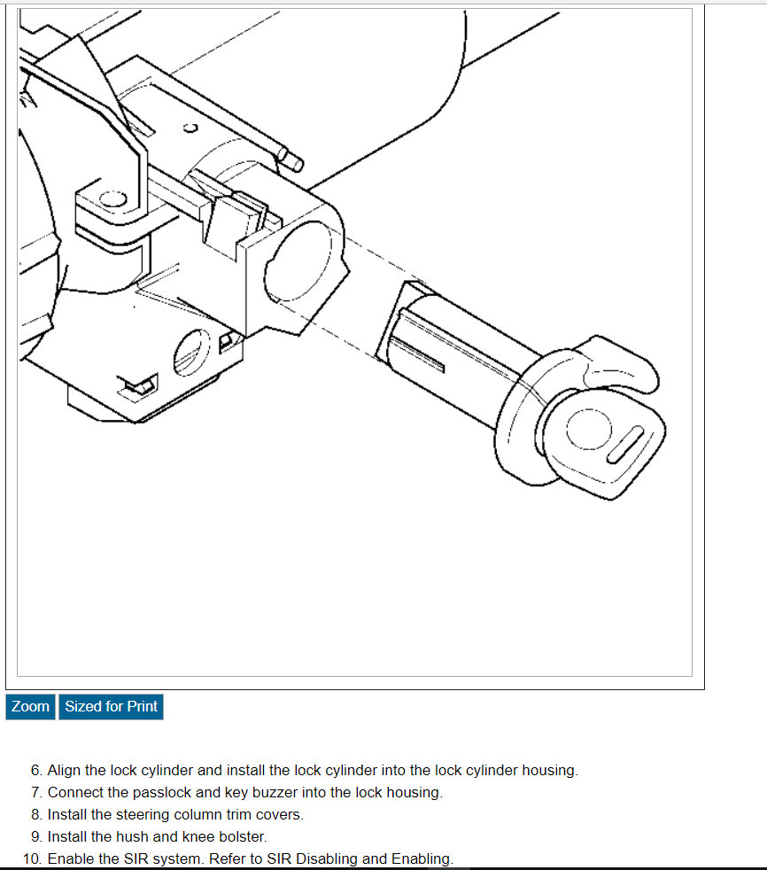

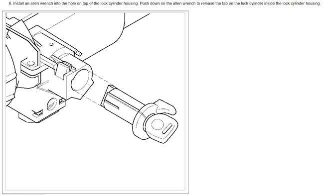

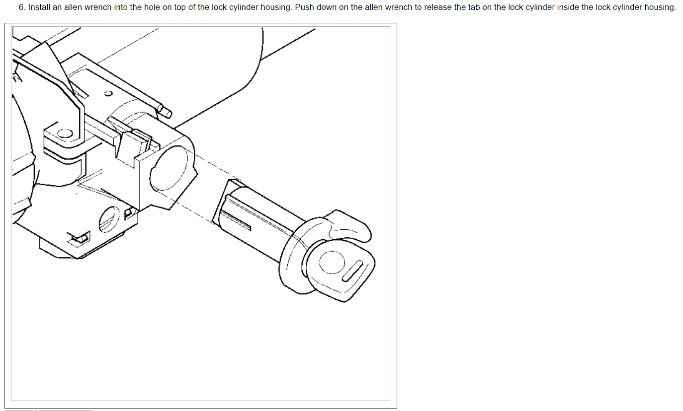

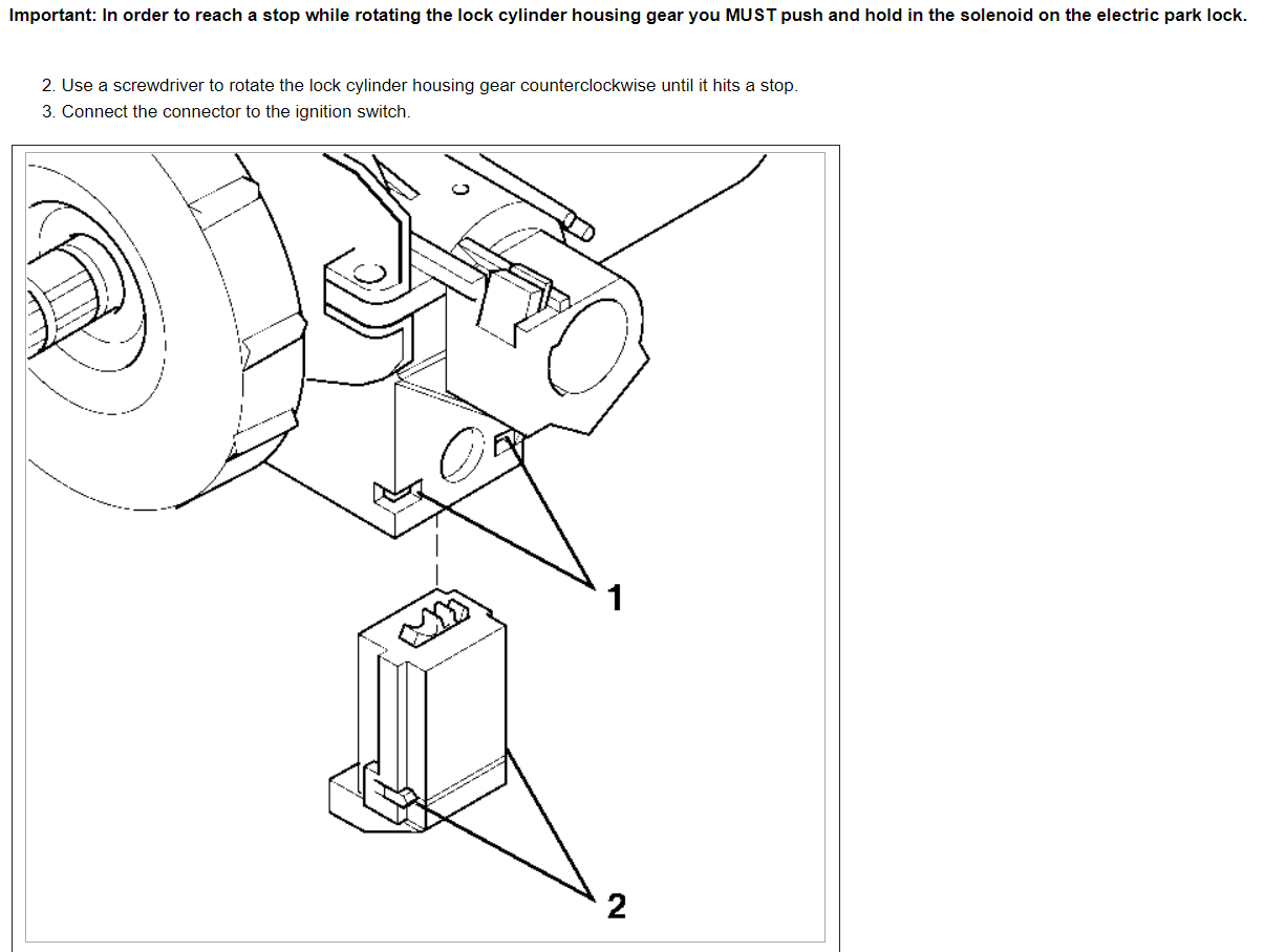

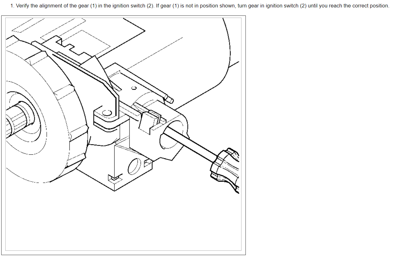

This is common when the key and tumbler where out and need to be replaced. Buy the new unit from the dealer and bring your VIN# and proof of ownership so they can code the new unit for you before it is installed. Check out the diagrams (Below). Please let us know if you need anything else to get the problem fixed.
