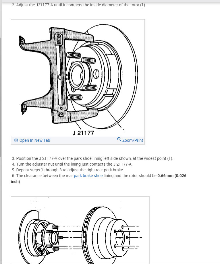

how do you adjust the parking brake? it's easier than normal to pull the handle, and they do not work. it has disk brakes in the rear.

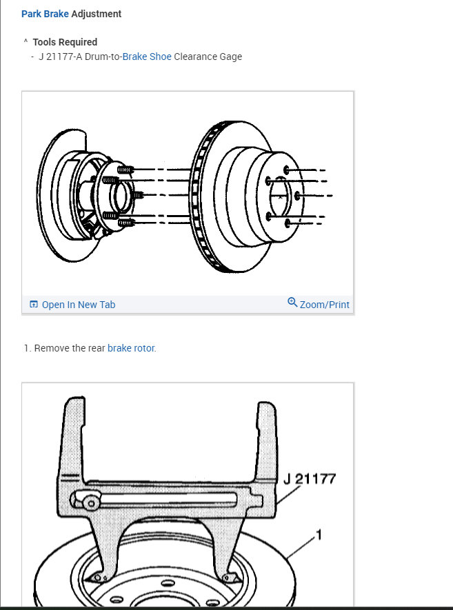

These are a little harder to adjust because it requires you to remove the rear rotors.
Here is a guide that will help with this:
https://www.2carpros.com/articles/parking-brake-shoe-replacement
You will find the info from the manual below on how to adjust these. Please run through this and let us know if you have other questions.
