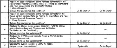

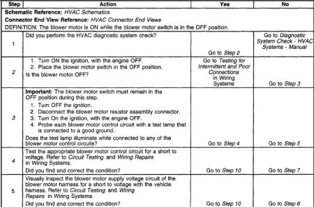

My blower motor continues to run even when the AC is turned off and even when the car is turned off. I can only stop it by pulling the fuse. According to the onwer's manual, there is no relay identified for the blower. I did pull the relay for the fan and AC, but neither stopped the blower. What else can I do to find the problem?
