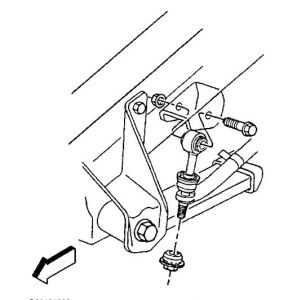

As the rear tires of the vehicle passes over bumps 30 mph or so; I hear a rattle/ thumping type noise coming under the left rear passenger side of the vehicle. I jacked the rear off the ground; check tire rotation, side to side movement, bolts, nuts and schock security; found nothing. Shocked vehicle back and forth and bounced on the bumper; found nothing.
Can you point me in the correct direction of what can be the issue causing the noise???

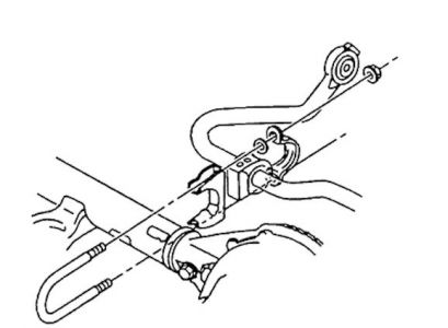

The first two places I would look would be the bushings at the sway bar to frame and then the stab link.
https://images.2carpros.com/forum/automotive_pictures/30961_env1_1.jpg
Grab the sway bar close to the bushing and agressively push pull.
https://images.2carpros.com/forum/automotive_pictures/30961_env2_1.jpg
Same on the stab links. Alos be sure it in nothing on the interior laying inside any compartment and be sure the spare tire has no movement.
