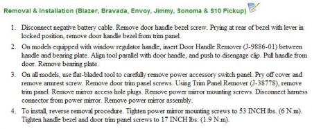

What are the necessary tools i need for removal of mirror?Exterior mirror

https://images.2carpros.com/forum/automotive_pictures/261618_Noname_1404.jpg
