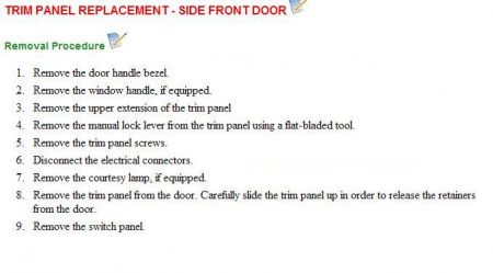

How do you remove door panel. This is an SLT model with all the power swithes in door and also the Bose speaker in door panel.

https://images.2carpros.com/forum/automotive_pictures/261618_Noname_883.jpg
