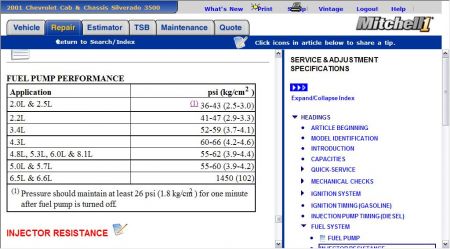

i have a 2001 gmc 3500 crew cab utility truck with the 6.0 engine.dual tanks ... truck started to hesitate while driving one day couldnt get out of it own way... next day would just crank .not fire.. no fuel... replaced fuel pump its been fine for about 15,000 miles then all of a sudden when driving again after say like 30 miles.. when u mash the pedal to the floor truck starts to stumble again... then dies... what could be the issue here... no check engine. no codes in history either..... also whats the normal fuel psi. with the vacuum to the pressure regualtor and with out

See below for regulated pressure-without the FPR should increase about 8-10psi over Hesitation try checking the throttle position sensor's closed and wide open throttle vpltages to include the MAP/MAF or engine load sensors.
https://images.2carpros.com/forum/automotive_pictures/12900_fuel_pump_pressure_1.jpg
