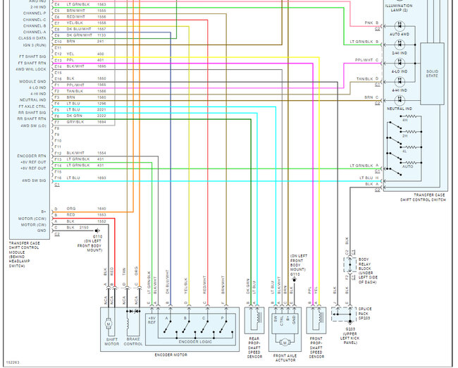

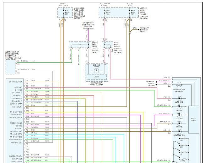

  • 55,849 POSTS
I would check the fuses, there are three fuses that run the system, turn the key on when checking fuse, here is a guide to help and the transfer case wiring diagrams so you can see how the system works and which fuses to check.

Check the three fuses that power the 4WD system with the key on, using the transfer-case wiring diagrams. The transfer-case shift motor on the side of the case is a common failure; if fuses are good, test or replace that motor. A dash selector switch replacement did not fix a similar case.
