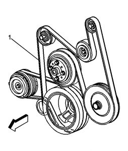

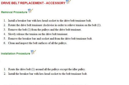

What is the best way to remove the serpentine belt in order to remove the alternator.
