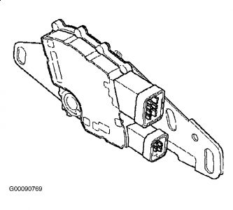

The vehicle is equipped with a column-type gearshift lever. In addition to the column gearshift lever provided for the operator, another component associated with shift selection is the Park/Neutral Position (PNP) switch mounted on the selector shaft. See Fig. 4 . The PNP switch transmits selector position information to the TCM. The PNP switch mounts directly onto the transmission housing from the outside, and detects the angular position of the shift selector shaft. This position is communicated to the TCM so that certain vehicle control functions can be coordinated with the position of the shift controls. The PNP switch has redundant circuitry to alert the TCM in the event of a single wire or switch failure. The Neutral signal output of the PNP switch is typically used as confirmation that the transmission is in Neutral before the engine starter is engaged. The PNP switch is interfaced to the starter circuit with weatherproof electrical connectors. The Reverse signal provision may be used to activate vehicle back-up lights and/or Reverse warning devices.
