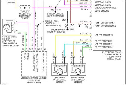

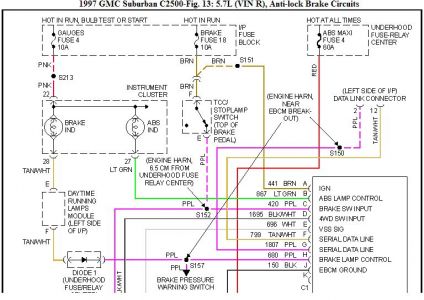

I'm going to break this down. I think we have 2 different problems here and they're unrelated. The stalling problem may well be a problem with the idle air control, IAC unit, on the intake/throttle body. It may just have to be removed and cleaned with carb cleaner. I attached a diagram of your ABS system. I had to post it 1/2 at a time or it would be too small to read. There are 3 speed sensors on the truck. One on each front wheel, and one on the output shaft of the trans. If any one of these 3 fails for just an instant, the ABS light will come on. 80% of the time it's one of these sensors that's scerwing up. When you had the codes check at Autozone, did they check the brake section of the ECM, or just the performance section. The reason I ask is, whatever tripped the ABS light should be stored in ECM memory, but in a different section
https://images.2carpros.com/forum/automotive_pictures/248092_gmc_brakes_1.jpg
https://images.2carpros.com/forum/automotive_pictures/248092_gmc_brakes_1_1.jpg

James,
Thank you SO much!!! That is great.
I will go back to Auto Zone and make sure that they checked for all codes, not just on engine performance.
I will check the IAC.
