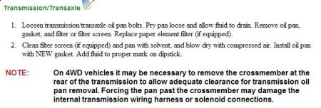

Transmission filter is located in the transmission pan. Below are proper steps to drain, replace filter, and refill auto tranny fluid.
https://images.2carpros.com/forum/automotive_pictures/261618_Noname_1473.jpg
