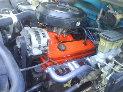

I have installed a new engine and headers and the existing O2 sensor will not reach the fitting on the header's collecter. I would like to replace the old senser with a new one as well. Is there any products that i could find that would reach and comply with my vehicle? I'm sure that I'm loosing power and milage without the O2 senser, and having the open fitting on my header. Thanks for your time[img:0939f0718c]http://www.2carpros.com/forum/automotive_pictures/216234_DSC00142_1.jpg[/img:0939f0718c]

First, use a bolt to plugg the hole. Next, call the local parts store and ask if they have a listing for an O2 sensor that woill work on your truck, but with a longer wiring harness. If not, you will need to custom make an extension.
