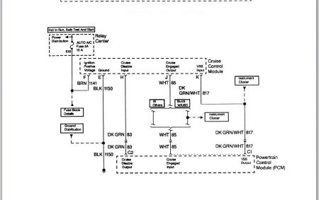

Hey ok i just got a gmc c1500 1995 and i put it on the scanner to check for codes and none came up only that brakes were applied???!!!! so we replaced the switch Still same thing Plus no Response to the ABS computer and tourge converter wont lock up cause computer thinks brakes on!!!>>

[quote:a2d412e0c6="Reco56"]Hey ok i just got a gmc c1500 1995 and i put it on the scanner to check for codes and none came up only that brakes were applied???!!!! so we replaced the switch Still same thing Plus no Response to the ABS computer and tourge converter wont lock up cause computer thinks brakes on!!!>>[/quote:a2d412e0c6]
which switch did you replace
and did you try to unplug the switch and test
good luck

BMRFIXIT
  • 19,053 POSTS
on the vin # what is your 4th and 8th this
https://images.2carpros.com/forum/automotive_pictures/99387_Image_3.jpg

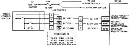

Oct 10, 2007 at 2:54 PM
RECO56
#4 is E and number 8 is K
Oct 10, 2007 at 3:22 PM
BMRFIXIT
  • 19,053 POSTS
try this
https://images.2carpros.com/forum/automotive_pictures/99387_Image_4.jpg
