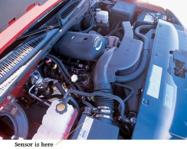

leadfoot33, This newer truck may be giving you a problem that wasn't found on older vehicles, like you said. The first inexpensive thing to try is cleaning the mass air flow sensor. The vehicle shifts according to engine load, vehicle speed, temperature....and on. If the sensor becomes coated an improper data stream reading will change one or all the shift points and feel. This sensor is mounted to the intake tubing right after the air filter.
https://images.2carpros.com/forum/automotive_pictures/435113_Engine532002_3.jpg
It can be cleaned with a sensor safe solvent available at an auto parts store, by spraying several shorts bursts directly onto the element. Simply remover the air filter top from the housing and then the air ducting it clamps onto. Once the sensor is cleaned the PCM (engine computer) must be reset either with an automotive scan tool that can reset the transmission adapt, or simply remove both battery cables and connect the two loose terminals together (don't touch the battery!) with a conductive material like a screwdriver for about 15 seconds. The initial ride afterwards will feel different regardless if it corrected your problem and will need a couple days to relearn you driving habits. Good Luck

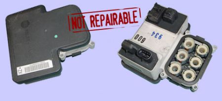

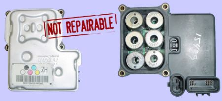

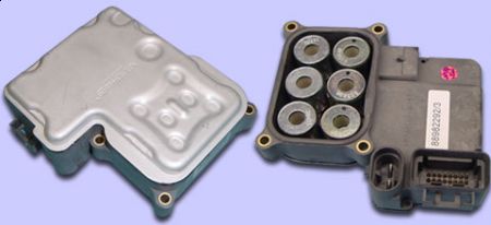

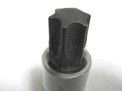

Perhaps it's not a coincidence. This model year, though more common in the 4X4 styles had a string of the Electronic Brake Control Unit (EBCU) failures. The symptoms were a growling noise on all the time even at stops with the vehicle in park and sometimes the key turned off. Does the noise you have been experiencing sound like the ABS is activated like if the vehicle were sliding? If so the ABS module requires replacement. These are easy to replace, but depending on the area you live in could have some corrosion on the small bolts holding it in place. Just be sure you have the torx socket straight on with the bolt and twist with firm even pressure. It is located on the drivers side under the vehicle tucked next to the frame rail just behind the drivers seat on the inside of the frame.
https://images.2carpros.com/forum/automotive_pictures/435113_ABSmodulechevyTruck_3.gif
https://images.2carpros.com/forum/automotive_pictures/435113_torx_3.jpg
Be sure the ignition switch is turned off before starting. Once you have it out the vehicle is okay to drive, just cover the hydraulic unit on the vehicle with tin foil. The repair will cost between $130 to $700 depending on which one your vehicle was equipped with. Some styles can be sent in for repair in just two days at an inexpensive price. If you have the non repairable style the dealer has many in stock to put on the same day at the more expensive price. REPAIRABLE UNIT
