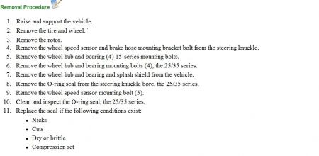

I am trying to replace the front hub. I have removed the brake assembly and the bolts in rear of the hub. The hub still wont come out.
