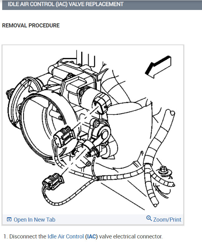

Engine idles at 600 RPM when cold but as the engine gets hotter the high idle increases to about 1500 RPM. A related problem may be that the AC is not working apparently due to low freon. Will the AC problem cause the engine idle contrls to over compensate?
Jul 2, 2008 at 7:50 AM
  • 75,992 POSTS
these are known for the IAC motor needs to be replaced. Here is a guide to help with guides below to show you how on your truck.
https://www.2carpros.com/articles/engine-idles-too-high
#30 in the diagrams Check out the diagrams (Below). Please let us know if you need anything else to get the problem fixed.

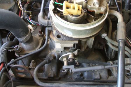

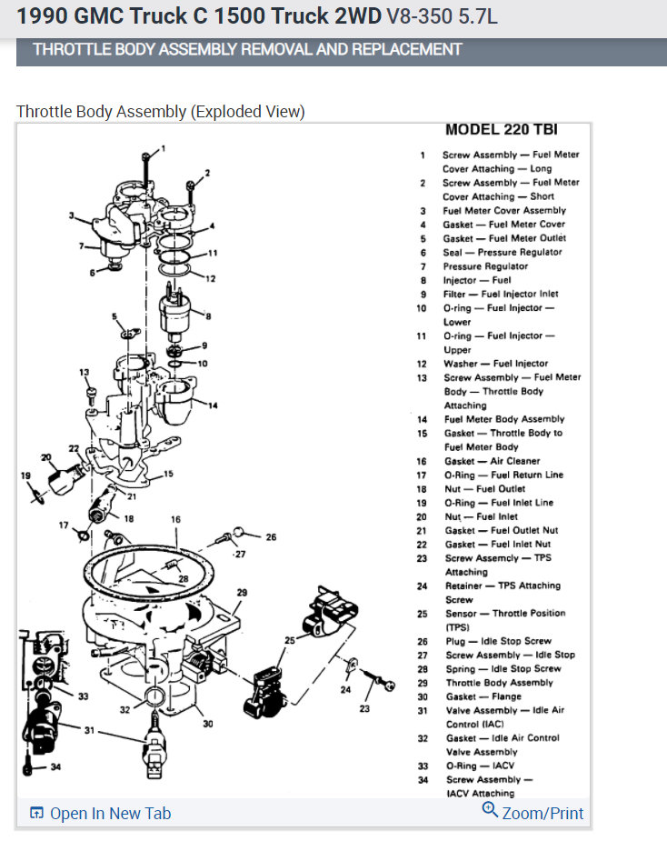

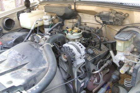

Hi Mike, My truck has a high idle that I have not been able to solve. I have replaced the Idle Air Control Valve (IAC), the Throttle Position Sensor (TPS), PVC valve and the Coolant Temperature Sensor. When driving I take my foot off the accellerator and the truck will continue at about 25 miles per hour speed. I am sending some pictures of the truck's engine.
https://images.2carpros.com/forum/automotive_pictures/46392_1990_GMC_Idle_Air_Control_and_Throttle_Position_Sensor_1.jpg
https://images.2carpros.com/forum/automotive_pictures/46392_1990_GMC_Gas_Throttle_2_1.jpg
https://images.2carpros.com/forum/automotive_pictures/46392_1990_GMC_Motor_View_1.jpg
Jan 7, 2021 at 4:35 AM (Merged)
  • 75,992 POSTS
Hi cmsgtsmith, Welcome to 2carpros
Check the fuel pressure should read 9-13psi
these are known for the gasket below the throttle body needs to be replaced. Here is a guide to help with guides below to show you how on your truck.
