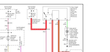

hey there my name is francisco from lemoore califorina im 19 years old. i have a auick question see if you guys can please help me.
my 98 sierra was driving one day i was hiting 45mph and it turns off on me i put 4 gallons of gas because i thought if was cuz my gas but then i try to start it up again and i wouldnt hear the fuel pump go on and i check the pressure by the carb and i couldnt hear it eaither i used the tester and on the fuse but there is like 3-4 wire there for the fuse/relay for the fuel pump and 3 of them dnt have power but 1 does but the wires from the fuse box dont have power to the back to turn on the fuel pump, but what i tryd to do with that wire that has power i but it to a fuse that works and the fuel pump will turn on and buy the engine u can hear it too but wont turn on like that eaither, so can ant1 help with this electrical.

Check and test ignition fuse E 10amp in underhood fuse/relay center and the fuel pump balance relay on fuel pump balance module
https://images.2carpros.com/forum/automotive_pictures/12900_fp_relay_19.jpg
