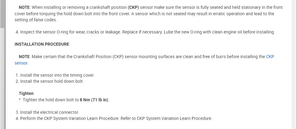

My truck just sputtered and died.....we have changed out the wires, rotor, and cap , distributor, module and coil......and i am still getting no spark when checked with lite? What else could it be????
Sep 10, 2010 at 10:55 AM

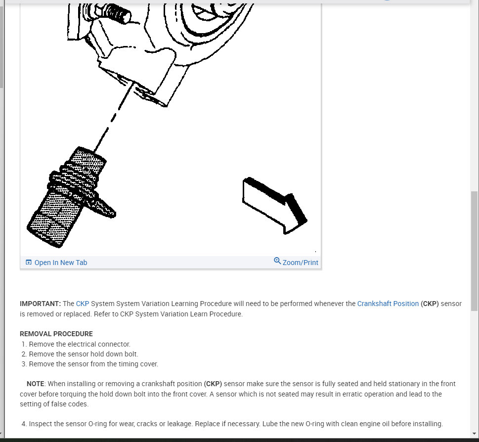

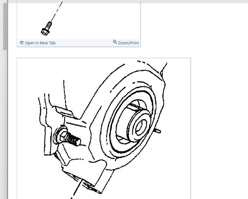

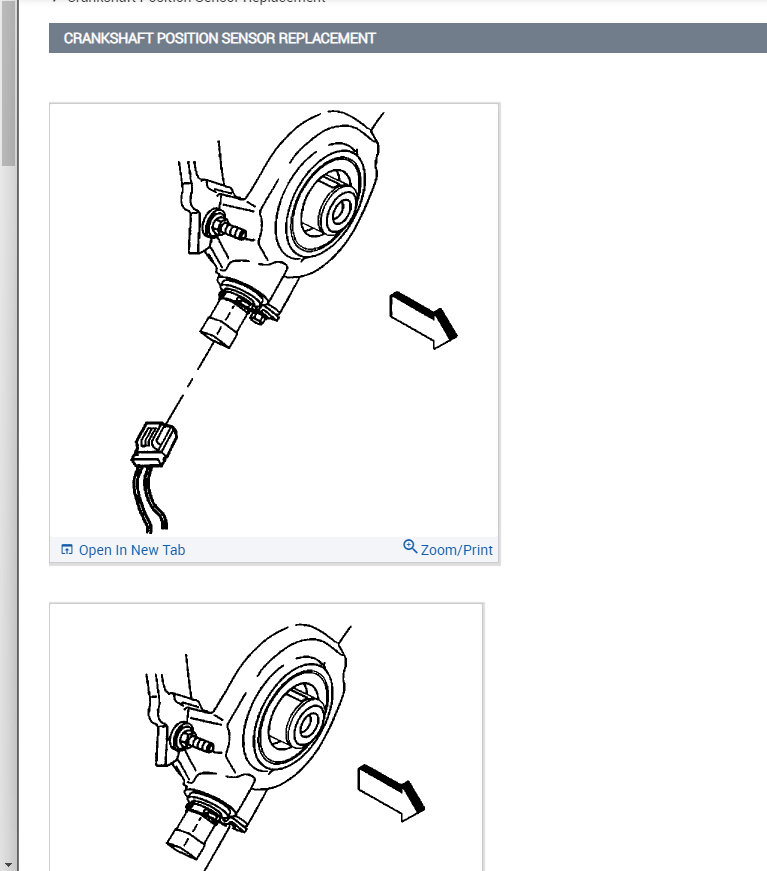

No spark is normally caused by a crank sensor issue. So, let's start with these guides and see what sounds like make sense. However, if it were me, I would replace the crank sensor and see if that gets the engine started.
I am attaching the info from the manual on how to replace this as well.
