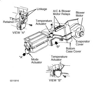

Have you replaced the blower motor resister? Relay?

I am having trouble locating the heater blower motor resistor help please

Yes, you donated more than enough, and thank you for that. Please don't be afraid to ask anything. First, the relay is located on the blower housing. The resister is also on the the blower motor housing. Here is a picture:
https://images.2carpros.com/forum/automotive_pictures/249084_relay_6.jpg
Let me know if this helps, and thanks for using 2carpros.com. Joe
