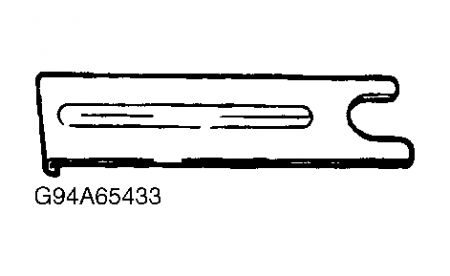

1996 GMC C1500 how do you disconect the quick disconect fit
D WEIGLE
Transmission problem
1996 GMC C1500 6 cyl Two Wheel Drive Manual
how do you disconnect the quick disconect fitting from the clutch & do you have to have the special tool?
Jun 8, 2010 at 2:17 AM
DOCFIXIT
  • 18,828 POSTS
Need special tool NAPA should have
https://images.2carpros.com/forum/automotive_pictures/198357_Graphic_470.jpg
Jun 9, 2010 at 3:55 AM
D WEIGLE
otc 7910 ...is the part number for the tool used to dissconect the clutch line from the slave cyl . one end of the tool is for 1996 & newer(ngv3500 trns) the other is for cars (simular to ford disconnect tool)
