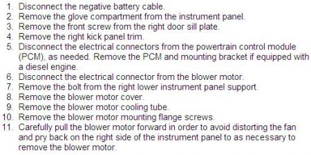

Trying to find out where the blower motor is located on the truck. I have been told that it is under the hood but they do not know excatly where.

https://images.2carpros.com/forum/automotive_pictures/170934_blower_motor_1.jpg
As far as blower motor removal, see above. That's what I found.
