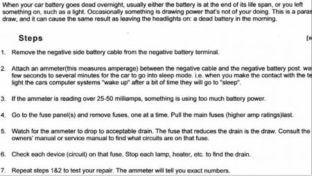

battery works alternator works battery drain whats wrong
Friday, October 15th, 2010 AT 10:41 PM
MECHANIC
75,992 POSTS
Do a battery drain test-here is a parastic draw-see below:
