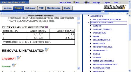

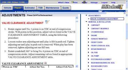

How does a back yard mechanic go about adjusting the lifters to the right adjustment with just simple tools. I know my valves are not opening and closing any where near the proper place

See below
