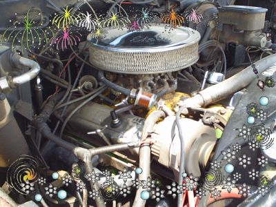

wat would cause it to ping, low oil , and how would i go about fixing it add oil or complete rebuilt, cause i'm looking at it right now and i can see were it leaks and it's out of the pressure insert and the plug on the bottom cause the bottom just get covered with oil when i wipe away the old stuff
https://images.2carpros.com/forum/automotive_pictures/258998_Photo0131_1.jpg
I uploaded a picture for you

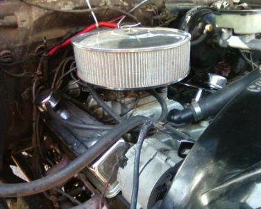

Ok a ping is caused by to much timing. If you set the timing to high then when you step on the gas it pings as soon as you let up and just cruise without putting it under a load the ping will stop. Now in the pic I see 2 breathers and no pcv valve this is not right and cannot run right either. Now the breather on the right (passanger side) remove it and get a pcv valve and hook the vacuum line to that instead. As you have hooked now it's causing the engine to lean out and this can cause a ping too. So first things first get that right first. As for the oil leak I can't see it but then I am not sure where you are refering too,unless it is the breather there on that valve cover and if it is then do as I have asked and replace it with the pcv and that should help a ton. Get back to me and we will go from there.
https://images.2carpros.com/forum/automotive_pictures/249564_1985ChevySilverado350_1.jpg
Like in this pic.
