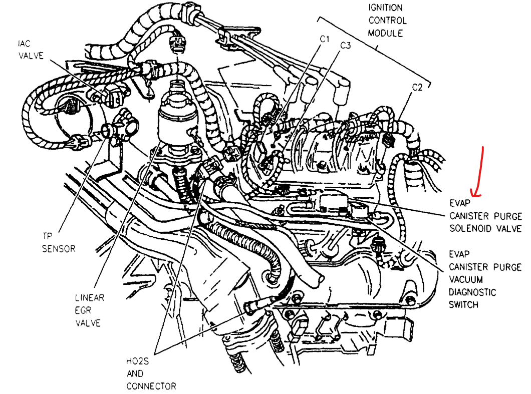

Car skipping. codes P0336, P0141, and P1441. Have changed crank position sensor. What does P1441 mean? engine to bog down when acceleration
Feb 24, 2025 at 11:38 PM
  • 55,381 POSTS
So this code is stored when the purge solenoid gets stuck open, you can confirm the issue when it is removed, and you can blow through it telling you it is bad.
P1441 - EVAP System Flow During Non-Purge Condition
Here is the location of the purge solenoid so you can check it out, be sure to clear the codes once the repairs are completed. Check out the images (below). Please let us know what happens.
