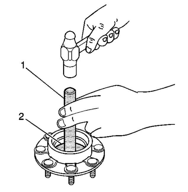

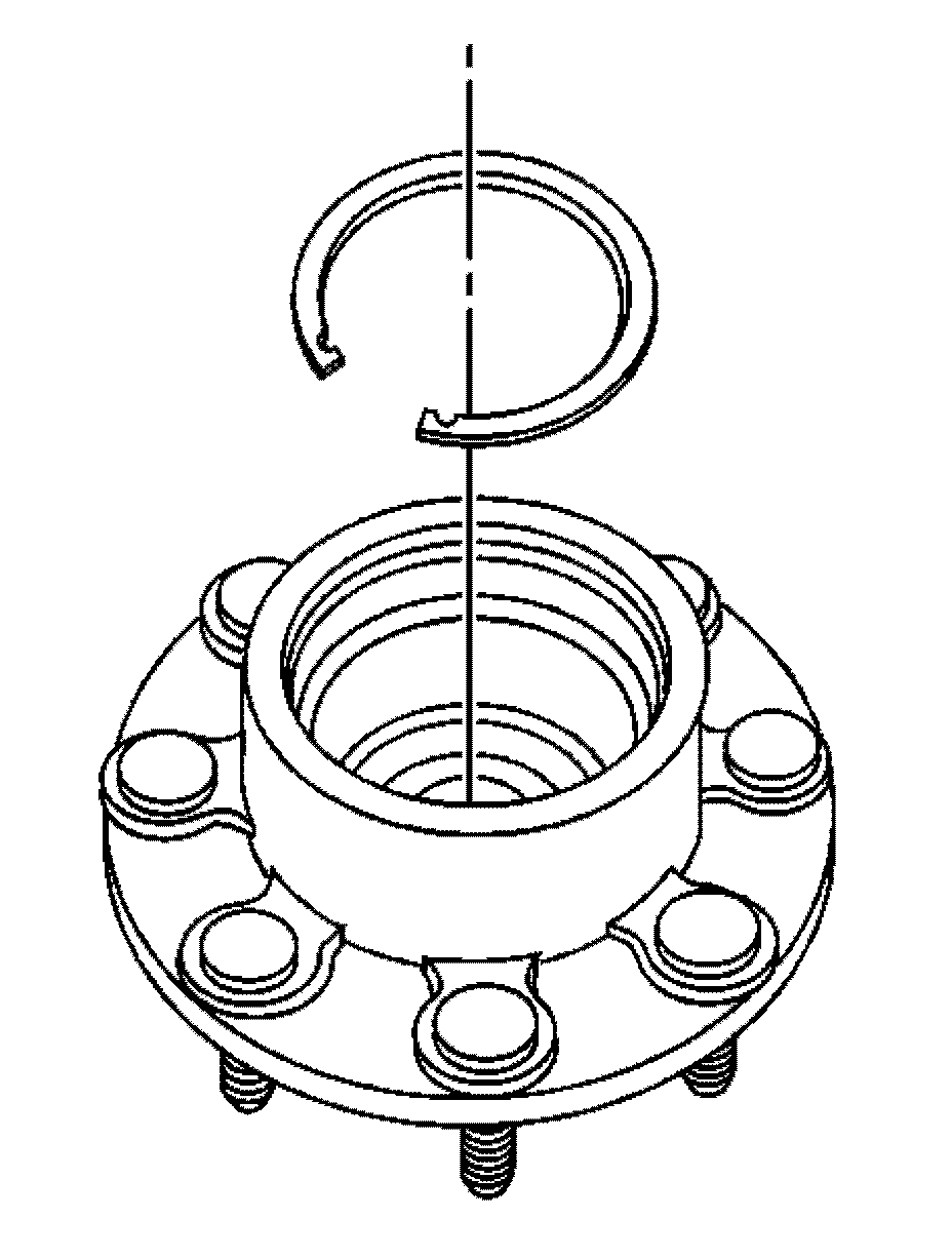

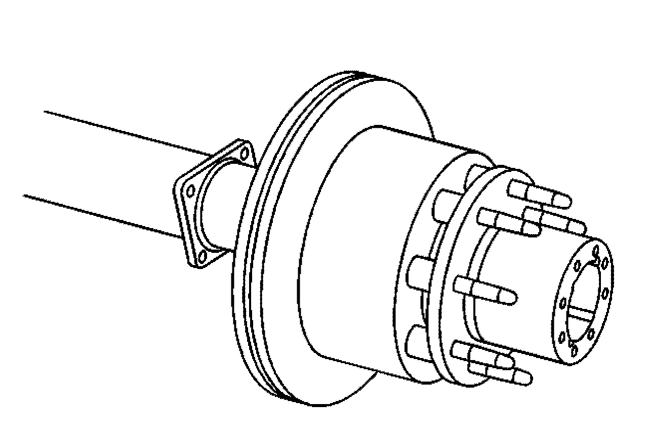

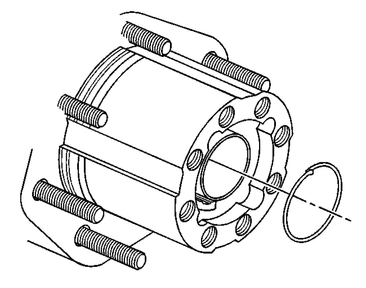

Do you have any information on how to remove the monster clip and the outer bearing and race. On the hub video you guys have on YouTube shows the inner bearing and seal it talks about the outer bearings but never shows it. I am a little confused on how it goes back in which direction does the race point. My truck is a 2500hd.

I am not sure which truck you have, so I went with the 2500. Here are the directions from Alldata. This video shows the job being done on a similar car but the process is the same.
https://youtu.be/EMxfb9X3ywE
All attached pictures correlate with these directions. I hope this is what you needed.
___________________________________________
Rear Axle Hub, Bearing, Cup, and/or Seal Replacement

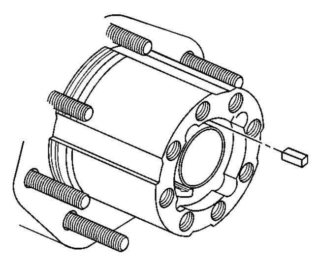

6. Remove the rear wheel bearing adjuster key.

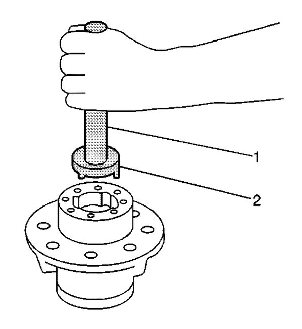

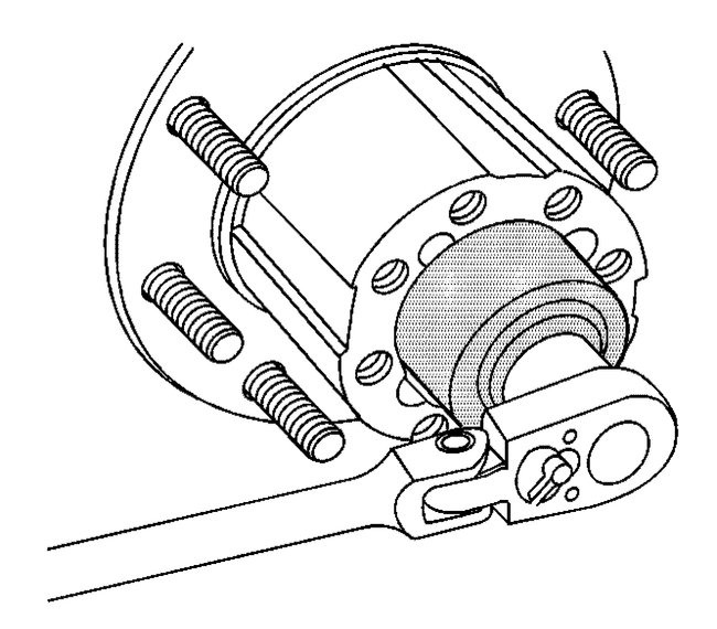

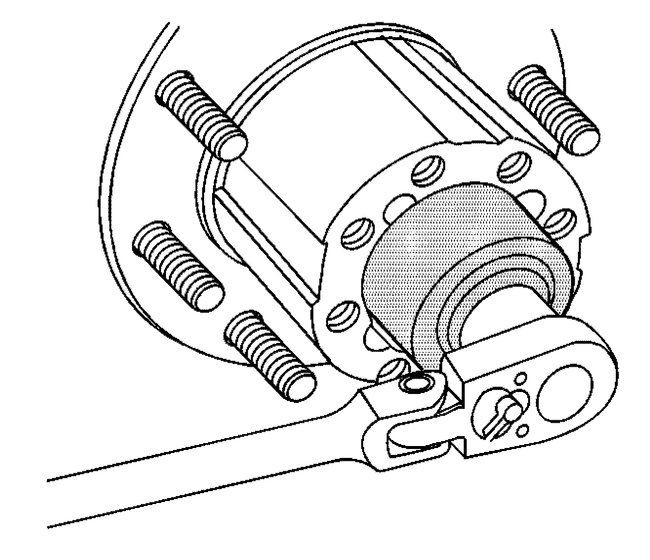

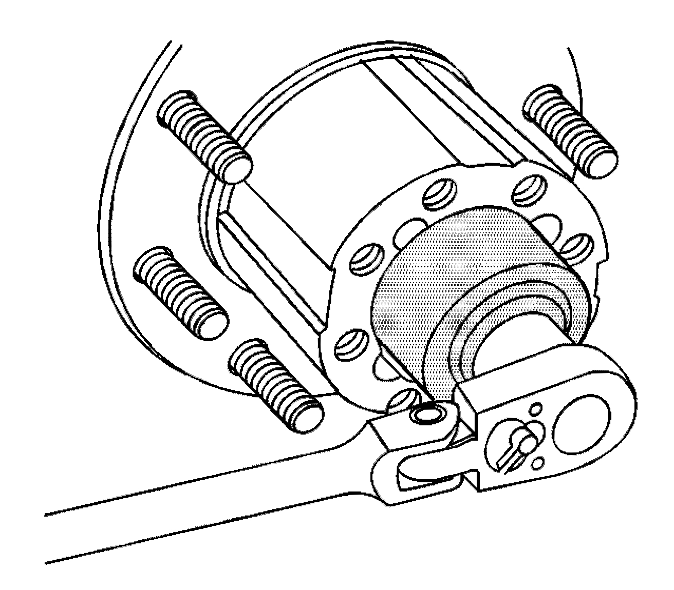

7. Using the J 2222-C wrench, remove the rear wheel bearing adjuster nut.

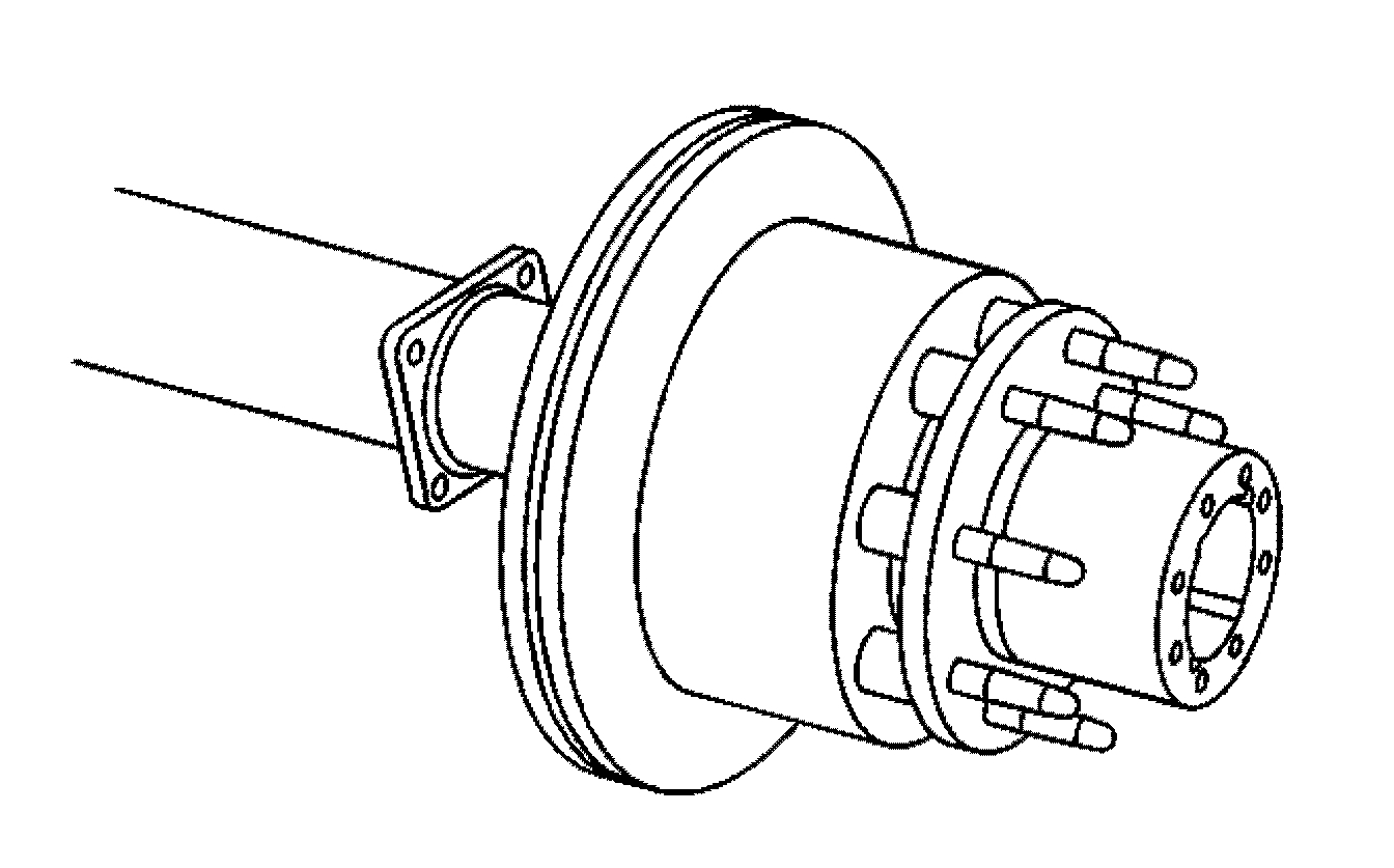

8. Remove the rear axle hub from the axle housing.
9. Remove the rear brake rotor, if necessary.

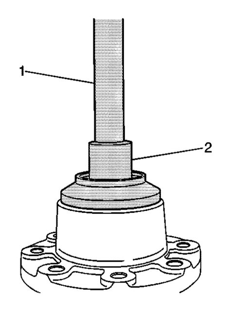

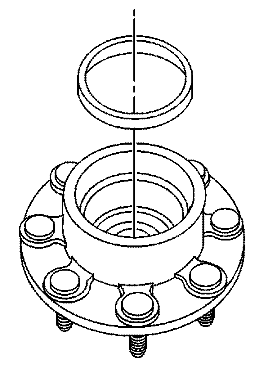

10. Using a suitable seal removal tool, remove the oil seal from the wheel hub.

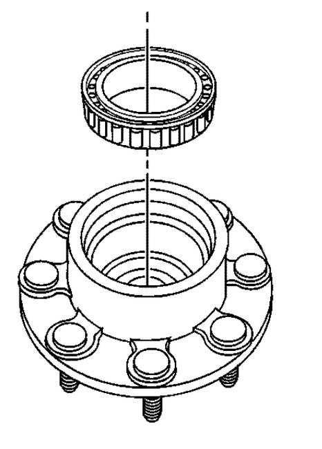

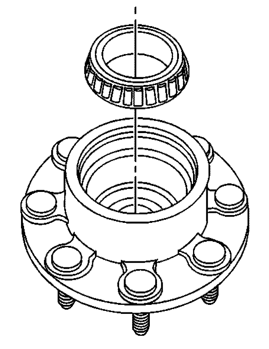

11. Remove the inner hub bearing.

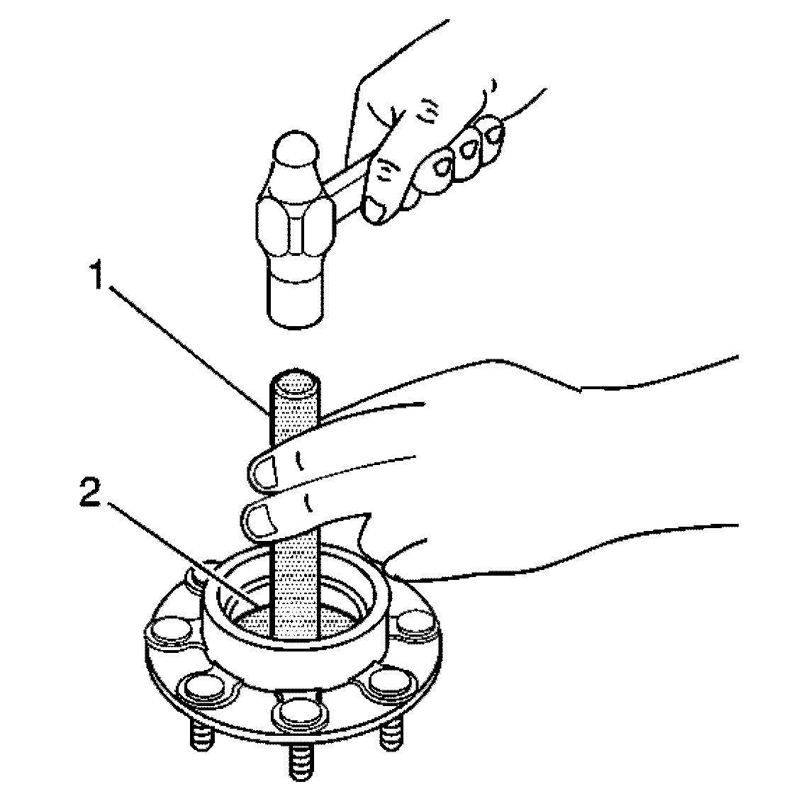

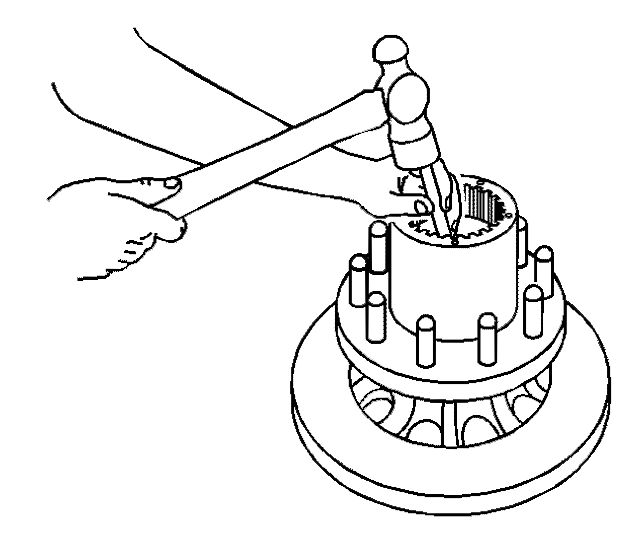

12. Using a brass drift and a hammer, remove the inner hub bearing cup.

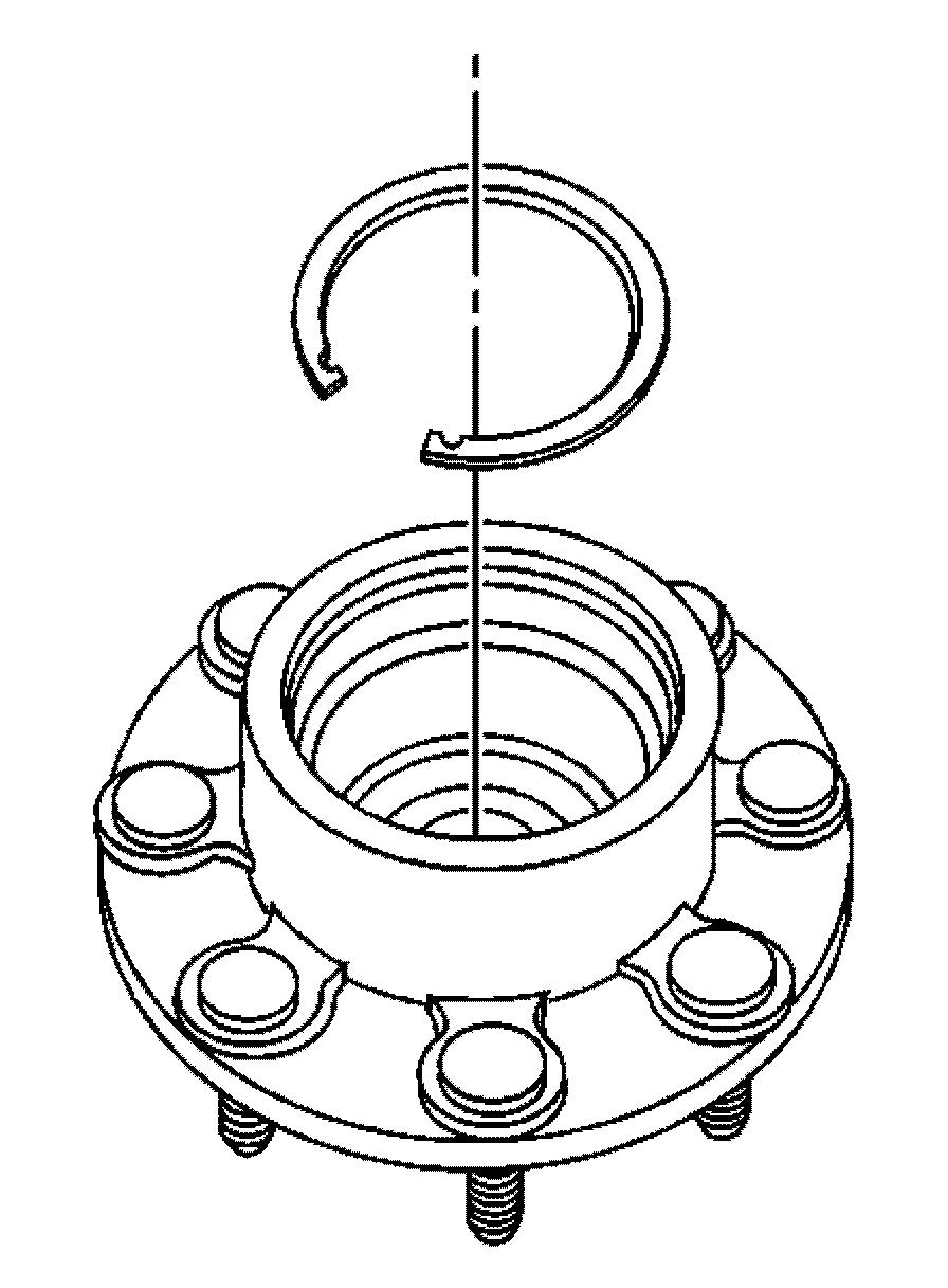

13. Remove the retaining ring from the wheel hub.

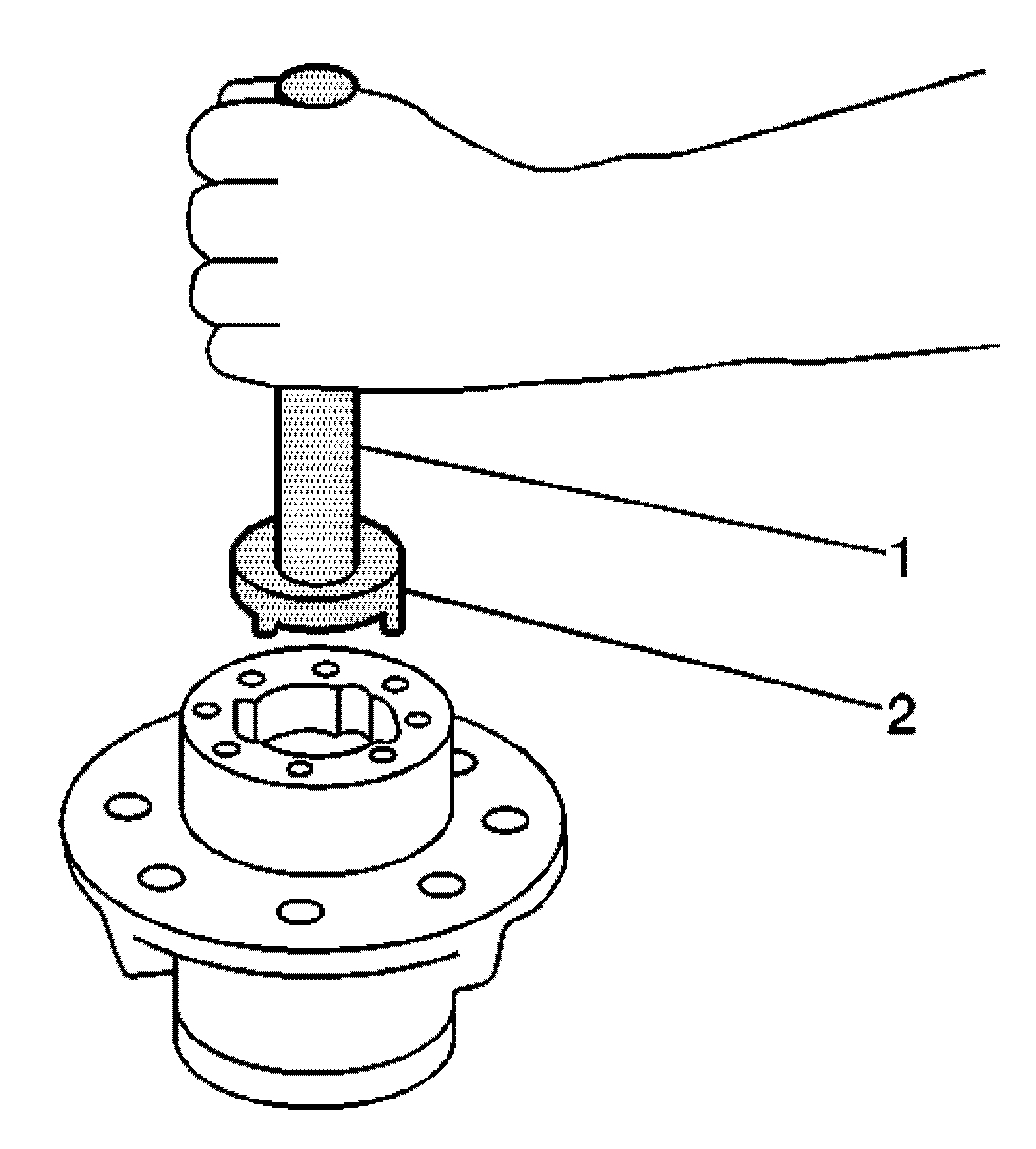

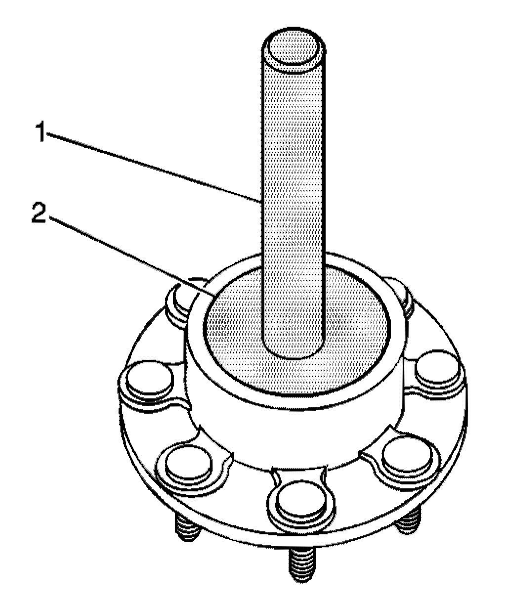

14. Using the J 24426 installer (2) and the J 8092 handle (1), remove the outer hub bearing and bearing cup.

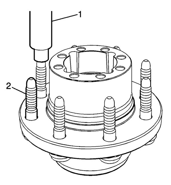

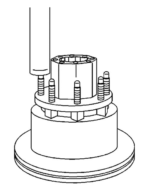

15. For those vehicles equipped with RPO code JH6, use the J 45270 (1) to remove the wheel studs (2).
16. For those vehicles equipped with RPO code JH7, use a hydraulic press to remove the wheel studs.
17. Remove the rear brake disc from the rear axle hub.

1. For vehicles equipped RPO code JH7, position the brake rotor on the rear axle hub.

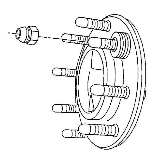

2. Position the wheel stud in the rear axle hub.
3. Using washers and a wheel nut, tighten the wheel nut until the wheel stud is fully seated in the rear axle hub.
4. Remove the lug nut and the washers.

7. Using the J 44419 installer (2) and the J 8092 handle (1), install the outer bearing cup into the rear axle hub.
Note: Ensure that the retaining ring is fully and evenly seated in the groove.
8. Install the retaining ring into the groove.

9. Using the J 24426 installer (2) and the J 8092 handle (1), turn the rear axle hub over and seat the outer bearing assembly against the retaining ring.

12. Install the inner bearing.

13. Using the J 44420 installer (2) and the J 8092 handle (1), install the new oil seal.

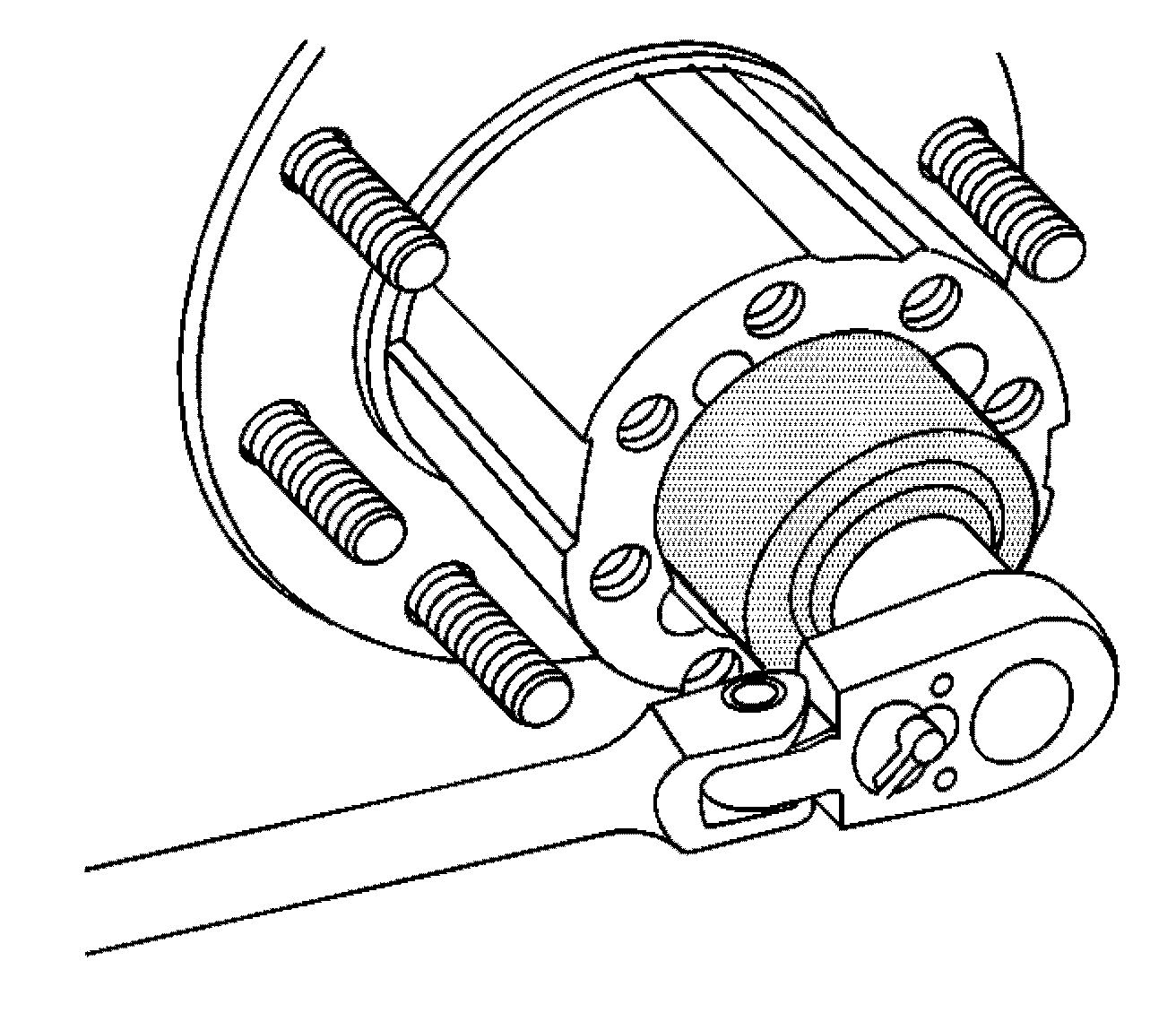

16. Using the J 2222-C wrench , adjust the rear wheel bearings.
