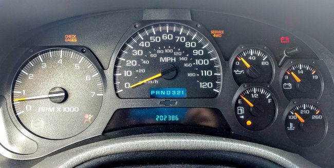

Hello!
About a week and a half ago after changing my oil, my GM cluster abruptly started malfunctioning. The oil pressure, gas, battery, and temperature gauges all go dead, the cluster light, service 4WD, battery symbol, ABS, (seat belt flashes for a while then disappears), and airbag lights go on. The RPM's and speedometer work, but the gear indicator doesn't show whether I'm in drive or reverse when changing direction. Any insight would be awesome.

Welcome back to 2CarPros. The common reason for this is bad solder joints on the circuit board in the cluster. They crack because of the lead free solder used on them. The repair is to remove the cluster and re-flow the solder joints. If you would like to see how the repairs are done go to YouTube and look for jeffescortlx. He has a bunch of videos about cluster repairs.
To get the cluster out you disconnect the negative battery cable. Then remove the closeout panel under the steering column. Then the knee bolster trim panel. Now remove the screws that secure the dash trim panel. Now you can move the panel far enough to get to the screws that hold the instrument cluster and removing it by removing the screws and the electrical connectors. If you know how to solder and have the correct tools the repair isn't hard, but it is very easy to damage the board so be careful.

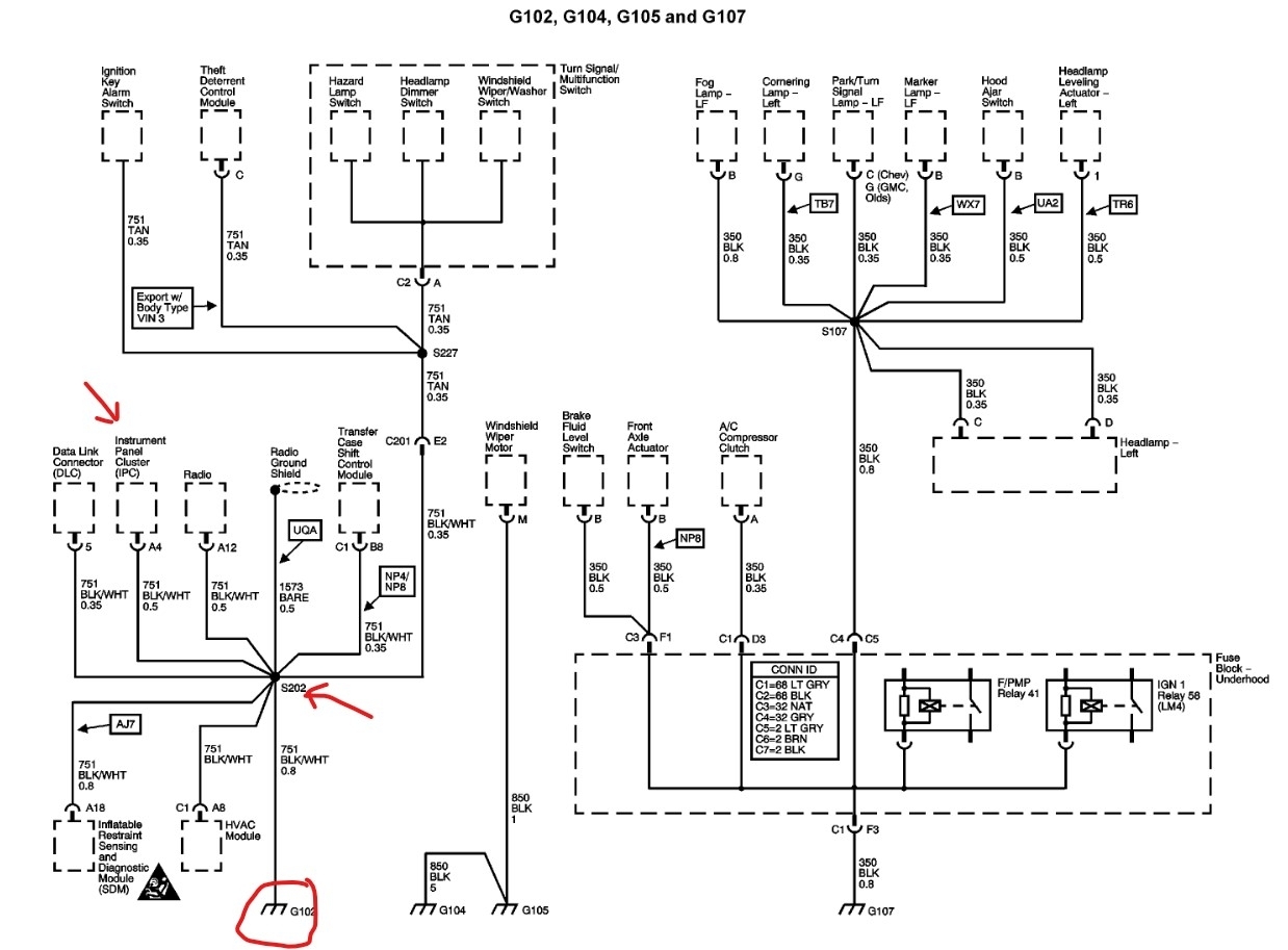

STEVE W.
  • 15,332 POSTS
Overall it suggests a bad connection more than anything else. Especially the lights flickering due to road vibrations.
I would start by doing what is known as voltage drop testing. What you do is take a multimeter and set it to voltage and then measure from one ground point to battery negative. The voltage between them in a perfect world should be zero, but because there is always some resistance in the wires and connections seeing a small amount of voltage is normal, what you don't want to see would be something like a full volt or more. That would show a bad ground. There are tons of videos explaining the procedure.
These are a smattering of them:
https://www.youtube.com/watch?v=l734h_SThcA
https://www.youtube.com/watch?v=7u5KNNB5Zjc
https://www.youtube.com/watch?v=qdaOSiScEu8
My suspicion is that there is a bad connection that is causing your dash issue. Likely a ground in a spot that has been overlooked. Tracking it can be an issue simply because yours is intermittent.
I'd almost suggest trying a bypass wire for testing. Say running a ground from the battery negative to the body, then one from the body to the dash ground and see if the issue goes away. Because it isn't causing problems other than the lamps flashing, I don't think it's the battery to engine or battery to chassis grounding that is the issue but something in the battery to body but being it's acting the way it is the issue will not be easy to track down. It will likely need to have a meter connected between the grounds, then move and shake the harness under the dash and at either ground and see if the issue shows up.
