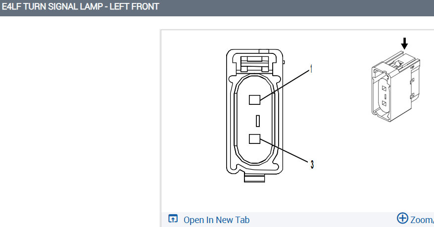

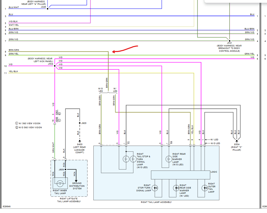

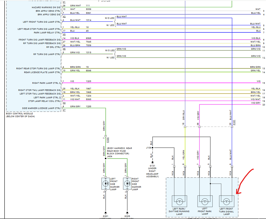

On my 2023 eqinox The left front and right rear turn signals are showing they are not working. The bulbs do not light up because power is not being delivered to the bulbs.I checked all bulbs, wires , grounds. Everything seems good except I believe the bcm is not functioning properly. I need the pin out wiring diagram so I can check each wire.

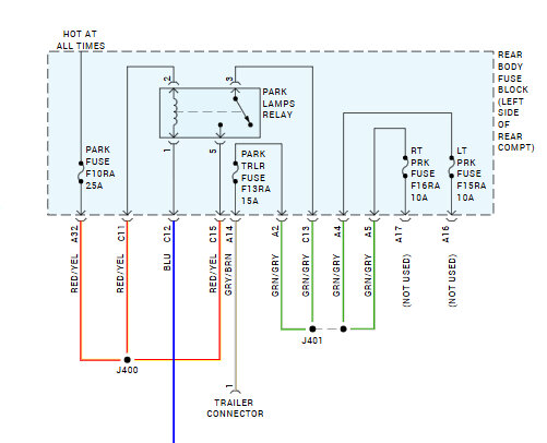

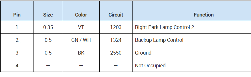

Sure, but I would do a CAN scan to show if the BCM has codes of failure stored. Also, with the key on check the fuses on the BCM as well. I have seen a bad fuse cause this issue.
CAN SCAN - https://youtu.be/u-4syLc-ifQ
So you may have a bd BCM if the fuse are good, has the car been in an accident recently? This can cause wiring damage, also rodents can eat wires as well. Also, you might wat to try doing a hard system reboot to help reset the system, this video will show you how
https://www.youtube.com/watch?v=INiDRO5A5MY

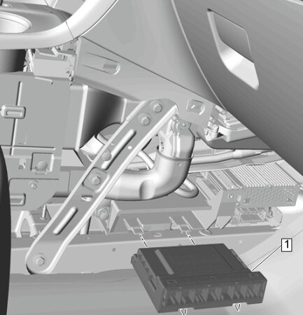

Here is the location of the BCM, (I have seen these get wet and fail) you can find a preprogrammed unit if you search google or ebay, I would check the electrical connector for corrosion, after you disconnect the battery, please go over these guides and get back to us. Check out the images (below). Ken

Thank you. I scanned it and no codes. No accident ever. Yesterday the hazard lights would not light the bulbs up in the left front or right rear. Today they do but turn signal with same bulbs still doesn't work. The radio screen has worked all day today, Yesterday was blank most of the time. I took it on a 900 mile ride yesterday and today. I ran a wire from front right to rear right just so I had rear signals while driving. The right side flashed fast and indicated it was out but with my jumper wire was working. It all started with radio screen going blank to staying blank. Then the turn signals stopped. Now radio working all day still no turn signals. I couldn't find a pre-programmed one on internet.

Did you do a CAN scan? This is different than a normal drivetrain scan. Also, did you check the fuses and bulbs in the front left and right rear? If any of the bulbs in the lens are bad it can create this problem. The radio issue can be separate from the lighting. I would make sure it was a CAN scan, check the fuses and bulbs before continuing. I found this company that can help with the BCM
