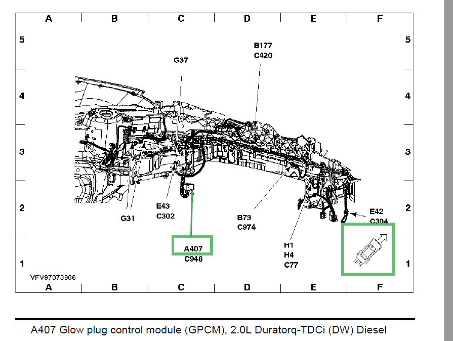

Does anyone know where the glow plugs control unit is located on Mondeo mk4 2.0 tdci ?

Unfortunately we don't have service manual for this vehicle due to it not being offered in the USA. However, after doing some digging, I was able to turn this document up. It appears to be for a 2007 but I am pretty sure they are the same through 2011.
If this is not it, let me know and I will reach out to one of my Ford dealers and see if they have access to this vehicle's manual. Thanks

Hi, thank you a lot for your reply. Much appreciated. I didn’t realize that this is an American website. I really had a look at the drawing I assumed that’s the side where the battery and the air box are so I removed both of them looking for this control unit but sadly there is no sign of it . It would be much appreciated if you could send us some more details.

As for the location of this diagram. I believe you are correct. I circled the left (from the prospective of sitting inside the car) front shock tower to try and orientate yourself. From reading about this on different websites it appears that is where others are finding it which is under the air box.
If it is not there, I will reach out and see if I can get different resources from my contacts that I have over the years. Thanks
