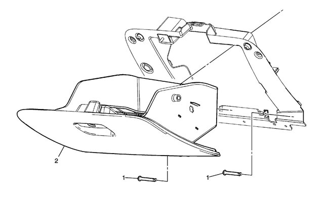

I can't get the glove box off. Removed 5 screws and popped open but the door hinges are attached by two pins that fit into the main dash. No obvious method to remove.

The pins should pull out. Then you remove the screws to lower the frame and disconnect the switch and lamp.

Thanks Steve. I came at it for about an hour from every direction. There's no obvious or accessible path to those pins. That's with everything else free except the door pins in the hinge. I've seen a picture where the insert/box is separated from the door, but that too has no obvious connection point and appears molded place.

Ok, I got the glove box out by removing the pins first with the door closed, and then removing the screws to pull the entire assembly out. Nothing straightforward in that sequence.i had to of course flip upside down on my back to work under the dash and push the tabbed end of the pin in reverse through the hinge.

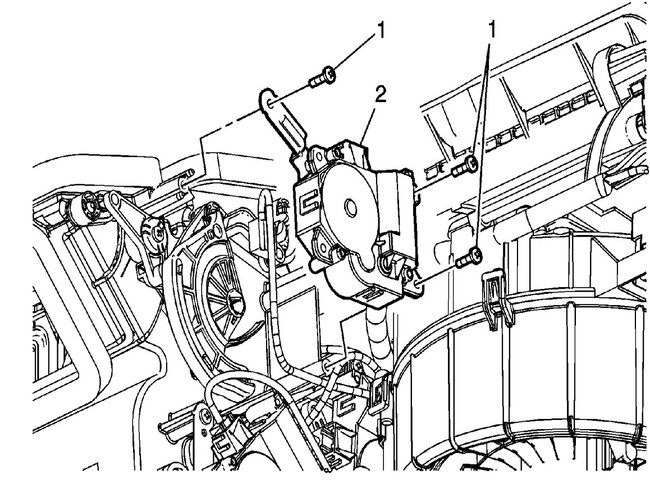

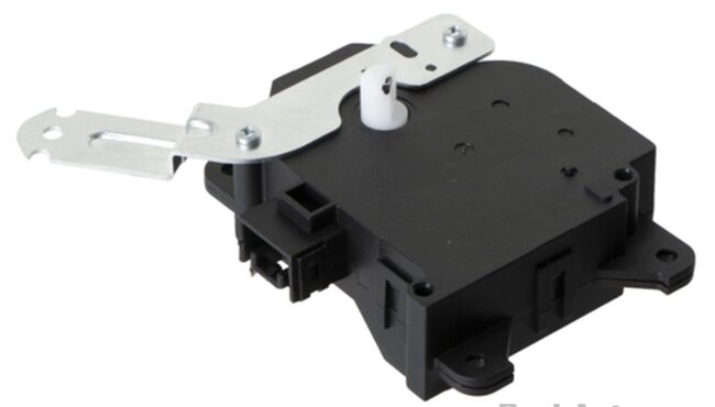

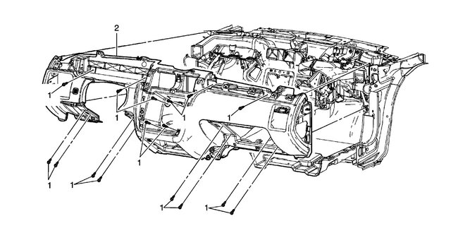

Which actuator are you trying to get to? The blend (temperature) door, mode (dash/floor/defrost) door, recirculate door (fresh air, interior). If it's the mode door you need the duct out of the way but that isn't that easy either as the screw that holds it can be difficult to access. Normally you pull the entire lower dash trim panel not just the glove box. GM pretty much hung the HVAC on the bare dash and added components around it.
Nov 26, 2025 at 9:03 AM
JOHNTAYLOR444
  • 5 POSTS
Yes, trying to get at the mode (dash/floor/defrost)
Nov 26, 2025 at 9:06 AM

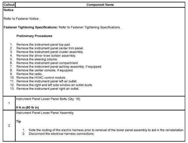

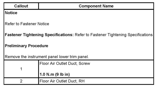

STEVE W.
  • 15,344 POSTS

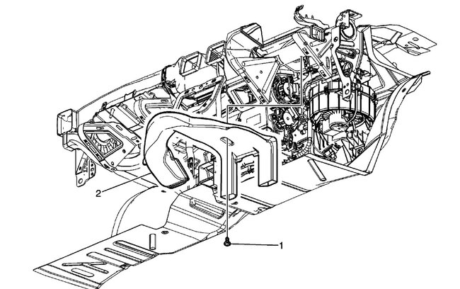

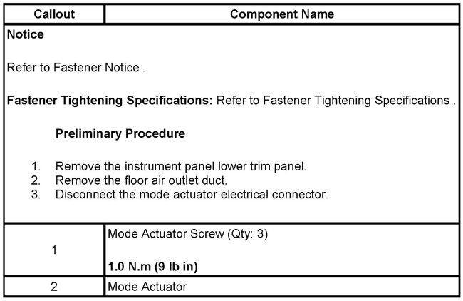

Yeah, the duct that is in the way is the lower floor duct. The problem is that the book instructions show a lot of extra steps. The last one I did was a heater core and I changed all the actuators while the HVAC case was out. These are the book steps. I think you might be able to remove the screw and shift the duct enough but it has been a while since I've been in one of those dashes.
Nov 26, 2025 at 9:28 AM
JOHNTAYLOR444
  • 5 POSTS
Thanks Steve. If that mode actuator only has one screw I'll probably give it a go. I can't see the bottom right fitting. The top two holes are just posts the actuator sits on with the lower left screw visible. It won't be easy but I may be able to get to it.
Can you tell me if it indeed only has that one screw?
Nov 26, 2025 at 9:38 AM
STEVE W.
  • 15,344 POSTS
It should have 3. One goes through the metal bracket and then 2 go through the plastic of the actuator behind the duct that you can't see.
