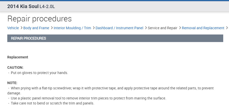

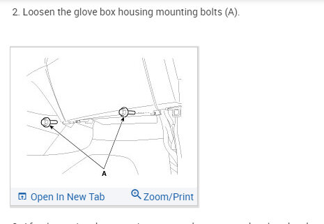

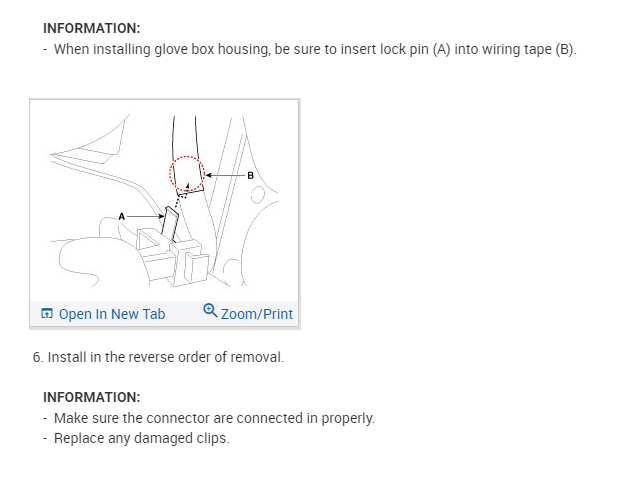

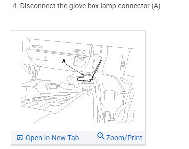

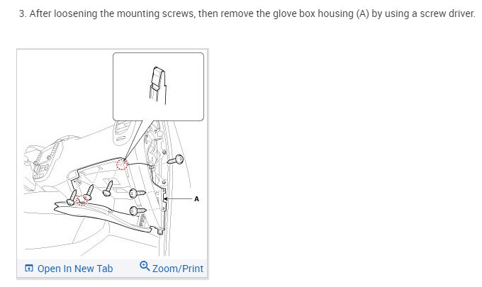

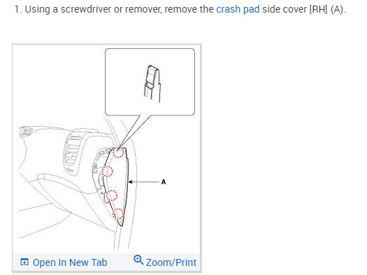

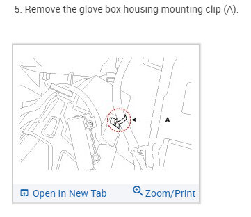

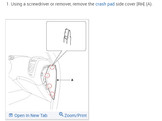

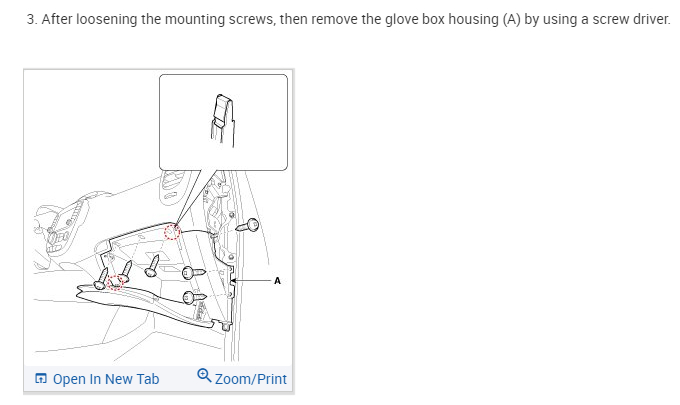

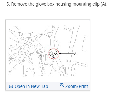

I provided the directions below for removing the entire glove box. I'm not sure if that is what you needed. For example, if you need to replace the cabin air filter, this doesn't need to be done.
Take a look through the directions and let me know if they help or if you need anything different.
Take care and let me know if this helps.
