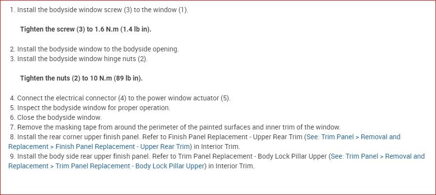

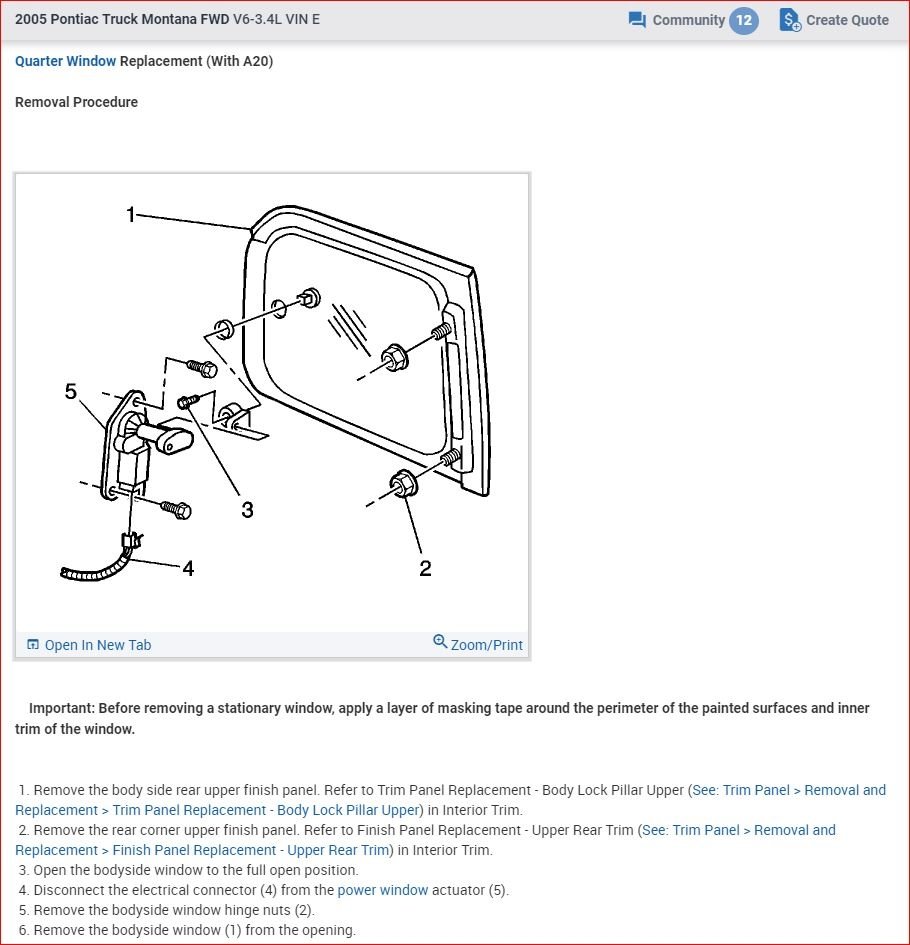

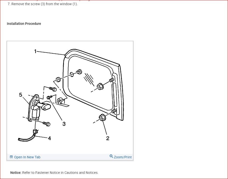

How to remove rear power quarter glass?
May 27, 2019 at 2:52 AM
Experienced Mechanic
18,907 POSTS
Hi Rickey,
Here is the procedure to remove the quarter glass. Please let me know if you need anything else. Check out the diagrams (Below). Please let us know if you need anything else to get the problem fixed. Thanks
